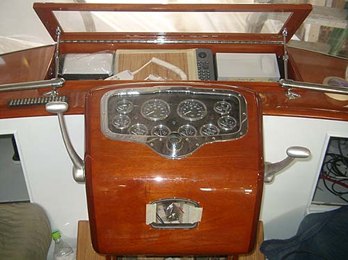

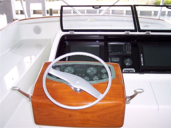

    NYCAP123 u just seem to be filled with knowledge, so u might know this one:) . when did the pod come in to play, thats another thing all battlewagons have in common, where the wheel and throttles are located on a pod coming off the console? who ever came up with that needs a medal, it makes reversing a pleasure, even more so with twin screws :D .
  3. NYCAP123
    11,209
    Thanks for the compliment, but I'm continually awed by how little I know. Some things can't help but catch with enough years though. By pod I guess your referring to that box under the wheel in your photo. DK, but I suspect SF captains had something to do with it as with bundling the gears to one side and the throttles to the other. Both situations just make it easier to face aft and operate by feel while backing down. As for timing I'll guess in the late 50's or early 60's. Again though this is just guesswork. You really need someone even older than me.

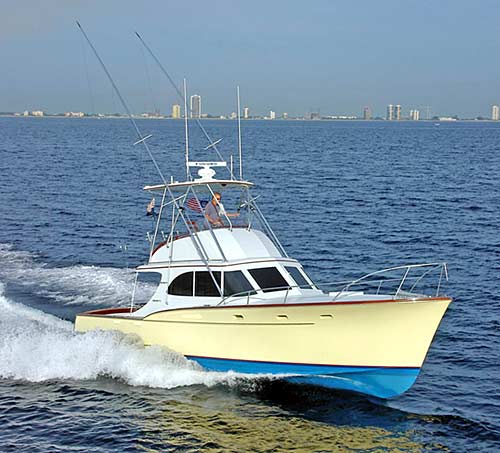

    i found a Rybovich... looks around 36'-ish long with the pod and controls to the side. the year... 80s... before my time so u ppl will have a better under standing of the history.
    anyway, thought u might enjoy the attachment.... she cuts the water nicely
    cheers
    far:D

    Now that's a proper boat, just as they should be.
  17. NYCAP123
    11,209
    Very pretty with just enough varnish to keep you real busy:D . Do you have any info? BTW, "80s... before my time". Had to throw that in eh. Love being told I'm old before my eyes are fully open. Your day will come;) .
