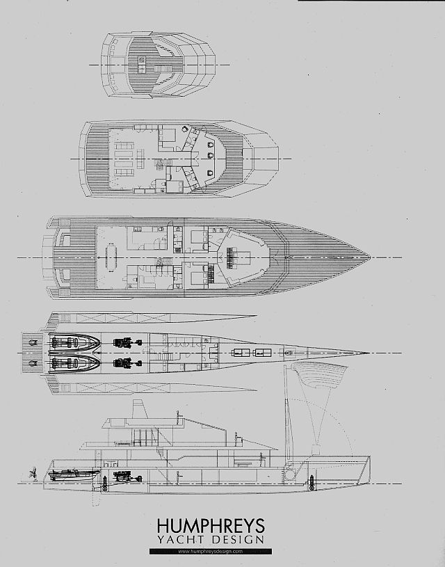

    SkySail Assisted POWERYacht
    Dear HTM09
    I've read a number of your postings, and I'd like to make a particular suggestion to you for your retirement/exploration vessel.....take it or leave it, its just an idea.
    I believe you should take a closer look at that Humphrey's design for a 40M SkySail Motor Yacht. Maybe look at that design with the idea of NOT putting the kite-assisted feature onboard, but perhaps retaining the small spaces needed to include that technology when it matures, or as an option that some future owner might place onboard.
    You can download a study PDF of that design HERE
    Other than that 'unusual technology' there are a lot of nice features to like about that design:
    1) Environmentally conscience. I believe you have expressed a desire to own an environmentally conscience vessel. Properly executed this vessel could be powered with relatively few engines, and of a size to get good fuel economy. Then ultimately you might experiment around with some sort of kite arrangement for long distance trips.
    You might note in their description that they utilize the term “SkySail-supplimented motor yacht”,....
    “The use of the word 'supplemented' is chosen carefully. While we expect this family of boats to be able to 'sail' very efficiently under SkySail, we foresee that fundamentally the boats have to be very efficient and seakindly Motoryachts, and in this respect the common denominator for efficiency under both forms of motive power is low hull resistance. Thus our work on this generic set has evolved towards slender body hulls that derive stability from wave-piercing outriggers which will have long range capability under engine, not to mention the 'free' miles under SkySail.
    What we envisage is a motoryacht with trans-ocean freedom of a large sailing yacht, able to fly the SkySail for sustained periods for relatively fast, comfortable and quiet 'sailing'”
    2) The engine room is nicely positioned, readily accessible from both ends, and expandable. Short shafts, retractable prop-drives are possible.
    3) Retractable prop-drives and retractable rudders could make this vessel a real shallow water capable explorer.
    4) Crew accommodations in the 'basement' could still be made quite roomy and ventilated.
    5) Two great master staterooms could exist, one at the fwd main deck level as shown, and one on the upper deck overlooking the 'BIG' aft deck recreation area.
    6) Owner and guess accommodations are all 'above the main deck with lots of comfortable living space,...even a nice flybridge area'.
    7)This 'stabilized monohull' design provides a very broad walk-around deck area, and a wide accommodations structure, while retaining a slender hull structure that is easier to push thru the water.
    8) With either a fixed or fold-back rear deck structure, there is a multitude of fun recreation options on this vessel,....a fishing deck, a swimming/diving platform, RIB launching, etc.
    If for some reason you didn't care for the external looks of the Humphrey's concept, you might have a look at a few illustrations I asked Mike Kajan to come up with for a shorter version.

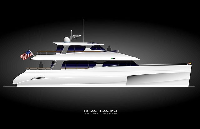

    http://www.yachtforums.com/forums/yacht-renderings-plans/14713-mike-kajan-yacht-designs-ii-7.html
    ....for instance
    I'm sure he could do more concepts on this theme, he is very creative that way.
    …..just some thoughts of mine.

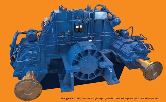

    The reason(s) for single prop and 2in1 gear with PTO/PTI gen/motor from my point of view are as follow: Given a hypothetical Explorer at around 200 ft in lengths, he would require a total propulsion power of app. 3000 KW. Staying below 3000 KW for crew requirement reasons. Taking a typical medium speed 3000 KW engine (MAN or MAC), it would require a engine room height of more than 15 to 17 feet. On a yacht, that means more than 2 decks. Taking two MTU 16V 4000 M53R or Cat 3516C at 1492 KW each would give the possibility for a 600 KWe shaft generator. With 2 additional app. 300 KWe diesel gensets, it would generate a true hybrid propulsion and the engineroom would stay within two decks.
    Single variable pitch prop for efficieny and sturdiness. The prop can be protected by keel and the larger very efficient rudder (split asymmetrical rudder with costa bulb) supported by upper and lower bearing. In case of damage, single prop blades could be exchanged by divers without the need for drydock (if really necessary). The Prop could even be equipped with Cord or Rice nozzle for more bollard pull, prevention of cavitation and damage protection. Keel cooling, exhaust gas cleaning and dry exhaust stacks for enviromental reason. Strong, reinforced, anfaired hull made of carbon steel (stronger in very cold water)
    The long range go everywhere Explorer / Expedition whatever purpose yacht.
    An interesting question would be, why not a SWATH design with sails?:confused: Sounds crazy, because the principle of SWATH and sails maybe dont work together. The trimming issue is most likely a nightmare.
    Below an example of a Wartsilä 2in1 gear with gen on gear in the size needed.
