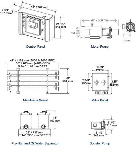

    He may be talking about the large Sea Recovery filter/separator units. If that is the case you have a large "junk" filter and then a large oil/water separator. It's different than some other setups where you have 2 small prefilters and than an oil/water separator.
    Lower left corner.

    Ya i have the commercial pre filter and then the oil/water separator. Capt J is also right in that it is in series.
    now i have a few oil water separators and no pre filters (spares). I dont see why i can't use this oil water separator filter in BOTH the pre filter canister and the oil/water separator. now from a financial standpoint i can understand the pre filter is cheaper and it wouldnt make sense to do what i am saying but since i already have 4 of these oil/water separators i dont see any technical reason not to.
    Commercial pre filter is 5 micron not sure about oil/water separator.

    Because using an oil/water seperator without a pre-filter, the oil water seperator will quickly clog with debris. Also the debris may stop the oil/water filter from filtering the oil. A lot of times you can usually find the pre-filters at your local hardware store in the water department in both 25 and 5 micron unless yours is a larger one.
