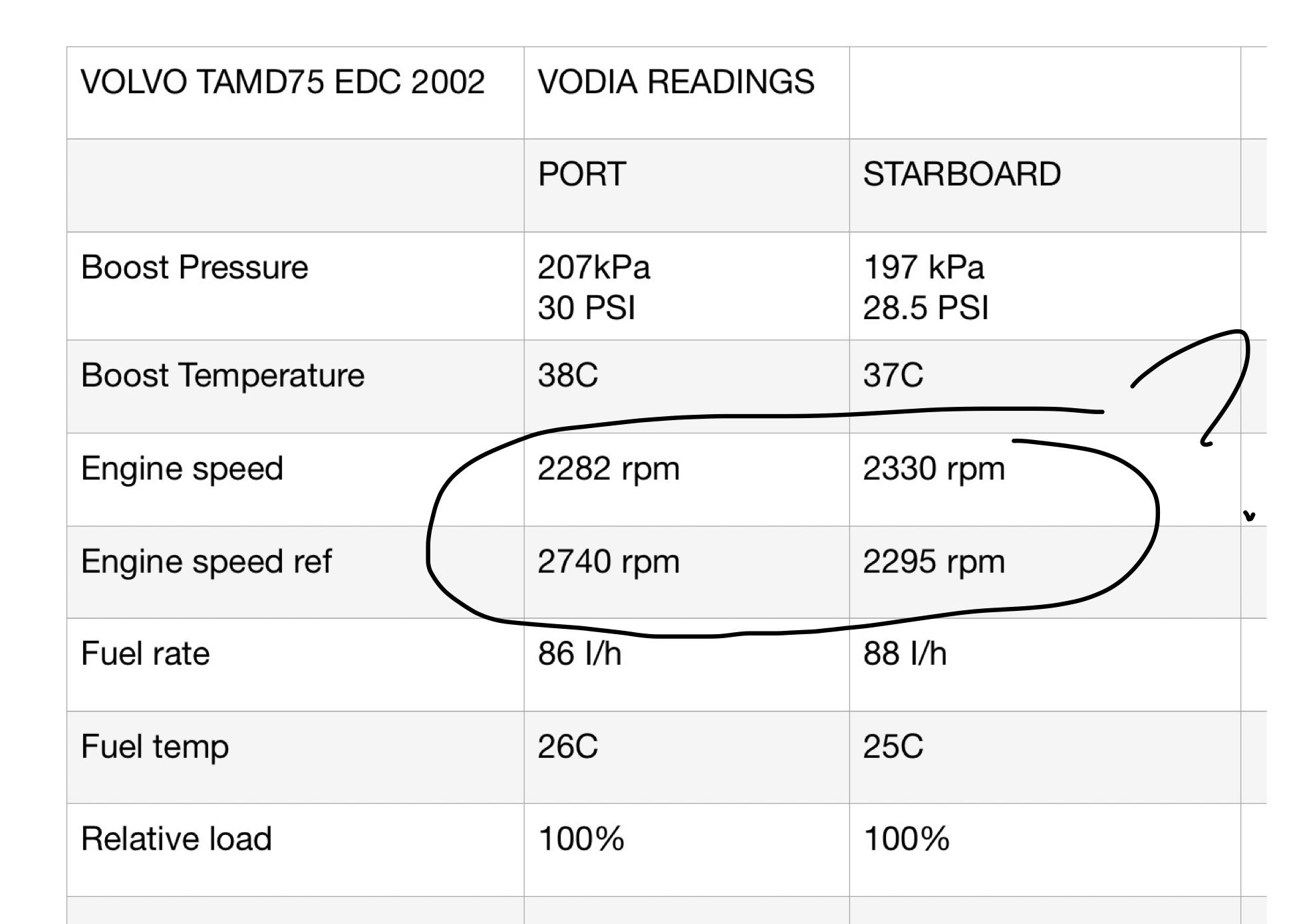

    Having similar problem - my 2002 TAMD74 are rated at 2600 WOT - boats run great - not smoke - but cant get past 2300 rpms. Here are latest VODIA readings - concerned about the lower engine rpm ref number - not suer what that means and where to look next.

    My problem was solved - turns out the props were
    Pitched incorrectly by the previous prop shop. Brought them back to spec and my 2300rpm went up to 2650 rpm WOT. Annoying - had 3 techs do 3 sea trials with the vodia. After last one - tech said everything perfect - pull the boat and check the props.
