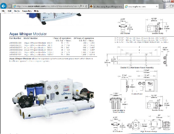

    I need to change the two membranes on my SeaRecovery AquaWhisper DX 900-2 gpd watermaker. Each membrane tube is approximately 25" although based on my search most membranes are 21 or 40 inches. From my research none of the 21" membranes will filter 900gpd. One will do 300gpd and assume two would do 600gpd so I'm not sure how to get to 900gpd. Can anyone explain what I need and if I need to buy from SeaRecovery or is there another company that supplies them to SR.

    Sometimes a pic will help.

    Just received an email from Ampac USA that their 2.5" 21" membrane is $198 ea. Need two. They say these are 800gpd instead of the 900gpd. Anyone know why these wouldn't work just reduce my output slightly.
    Actually just found out the membranes in the model I have are 3" x 21" so they maybe hard to find since 2.5" and 4" seem to be the normal.

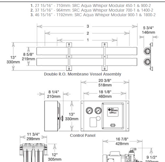

    Uh? You do or don't have 28" long tubes (model 900-2)??

    The 2 tubes are 25" long. Inside the tubes are the membranes which have about 2" open on each end before the caps.
    SR now tells me the membranes are 3" x 21" which appears to be an odd size.
