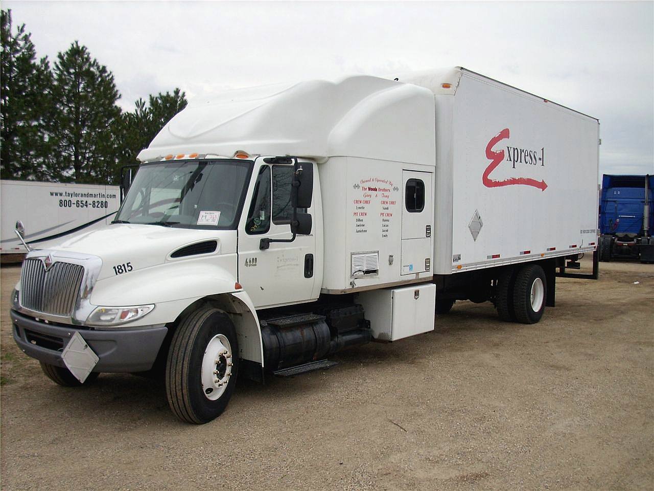

    I just drove my International 4400 210HP DT466 diesel "roamer hauler" truck halfway across the country empty, approx 10MPG when light on the accelerator (65 MPH or less), avg $3.00/gal about .10 cents more than gas. Love that turbo whine. Get into that throttle above 65 or even the smallest hill 3-5 mpg. I got the truck for $13K, 430K miles, I think 1600 hrs. You can buy a lot of gas for a diesel fuel consumption payback.

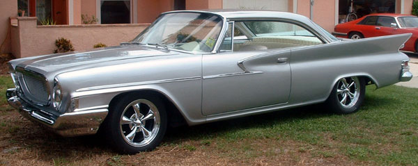

    For you 427 fans I have a 72 F100 w/390 reman ($2500) which gets about the same MPG and a lot more HP. Only difference is that puny little tank behind the front seat only gets you about 150 mi down the road vs the twin tanks on the roamer hauler cost $250 to fill a pop. Dont say I dont love FOMOCO, I just cant justify it anymore. I also have a 61 Chysler Newport w/361 and it flat out is a torqer. If you really want to be different go the MOPAR route like the sister Al crusiers from Marinette.
