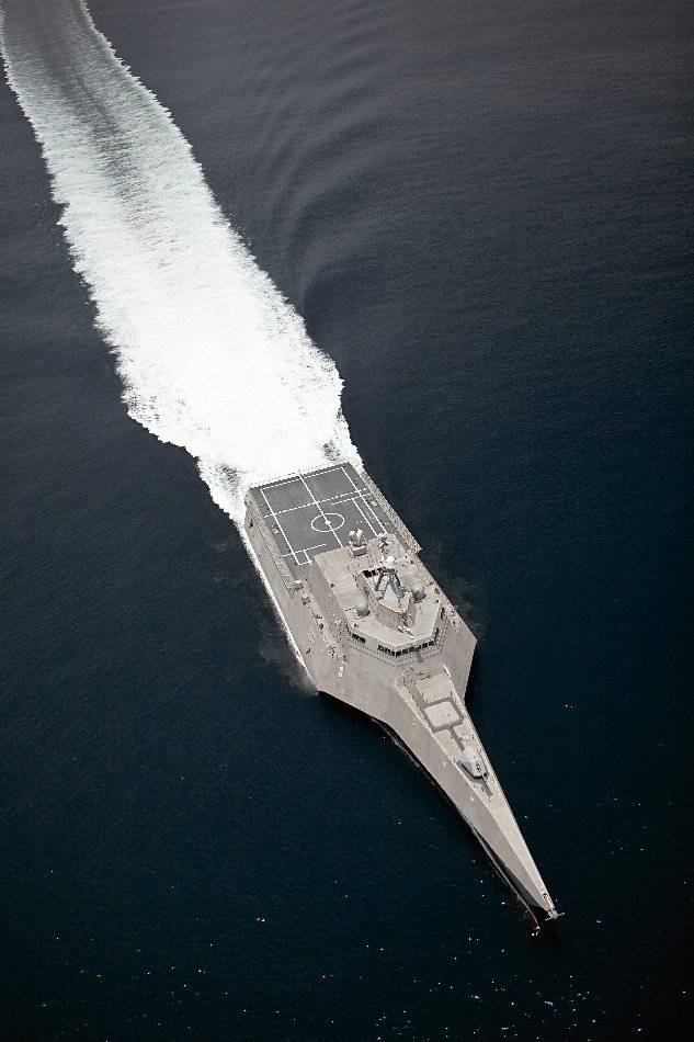

    Speaking of a great aft deck...on slender hulls ;)
    ...lets see, now shortened this vessel up a little bit and use a single engine powerplant with a controllable pod propulsion...hmmm:cool:

    ...and maybe leave some armament on there for those pirate situations :rolleyes:

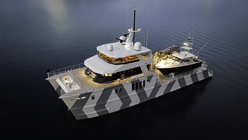

    That would make for quite a superyacht...imagine the interior volumn avaliable :eek:
    And I think it is nicely done, particularly when considering all those 'curvy windowed' new designs (I commented on this before HERE).
