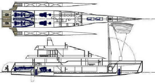

    Back to those design concept drawings by Humphrey’s (attached PDF).
    LINK
    I can fully imagine a scaled-down version of this tri-hull design, in the 65-70 foot range, with a wonderful rear ‘swim’ platform deck incorporating a sportfishing arrangement and/or a Scuba diving platform. Just inside could be a tender stowage as shown; or rather a complete diving & fish tackle facility. The tenders could then stow up on rear deck, or one forward, one aft.
    The power would be a single main engine sized to develop the vessel’s desired top speed, and it could transmit this power by conventional shaft/prop arrangement, or with a azimuthing Volvo IPS dual prop unit, or via a retractable azimuthing Rim-Drive prop unit as I included on my latest dynarig motorsailer design.
    1) Volvo IPS
    2) Rim Drive : Rim Drive
    Supplementing this single main engine would be a single DC diesel/electric power unit to provide for:
    1) Ships electrical requirements
    2) Slow speed operation by electric (wing) motor belted to main prop shaft
    3) Maneuvering thrusters as required depending upon azimuth capabilities of main prop.
    The entire ship would be powered by only two engines, basically sized to provide
    1) Full main diesel power, unimpeded by interceding diesel/electric conversion
    2) Slow speed operation and ship’s systems via the smaller diesel/electric unit
    3) ‘Twin power’ emergency backup as either engine can run all gear
    This configuration more ideally meets the latest thinking for the new diesel/electric DC technologies onboard smaller vessels. Alternatively, two identical diesel/electric plants might be sized such that in combination they would supply the max power required of the vessel, and half power for lesser times.
    Only two engines and no conventional sailing rig should make this a more affordable vessel, both in construction, in maintenance, and in operation. However the SkySail kite arrangement will probably more than offset the conventional sailing rig in cost. Possibly a less expensive alternative to this ‘brand name’, with less computerization could be found (no integrated weather/navigation features, etc). Light-weight construction would be desirable but not necessary. Third world hull construction materials are a possibility.
    I’ll call it a KiteSail Motorsailer for now.
    Your comments on these ideas are welcomed.

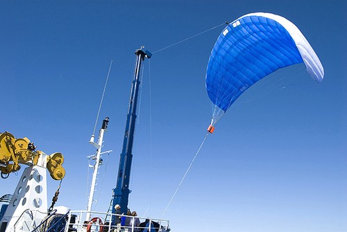

    Launching Photo
    Here is a nice launching photo of the SkySails unit

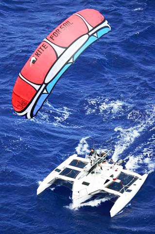

    Kite Cat
    Sorry for the rather rough sketch, but here's the kite rig on the catamaran ready for launch

    Maiden Voyage of SkySails Vessel
    A cargo ship has set off from Bremen to Venezuela to gain first-hand experience being towed partly by wind power. The newly built cargo vessel was towed by wind propulsion for the first time in the North Sea this month. The 160m2 SkySail supported the main engine of the 132m long Carrier MS “Beluga SkySails” of the Bremen-based Beluga Shipping with approx. five tons of tractive force at a low wind speed.
    The invention is that of a Hamburg-based company SkySails GmbH & Co.
    “The maiden voyage marks the beginning of the practical testing during regular shipping operations of the SkySails-System. During the next few months we will finally be able to prove that our technology works in practice und significantly reduces fuel consumption and emissions,” says Stephan Wrage, Managing Director, SkySails.
    Parallel and in addition to the practical tests on the MS “Beluga SkySails”, the SkySails technology is advanced and optimized for series production readiness on further ships.
    Stephan Brabeck, Technical Manager at SkySails: “Certainly, the daily routine at sea will still bear many challenges for SkySails. It is thus now particularly important to raise the manageability and robustness of the system to the level demanded by our customers. We will have to face up to many challenges and in the process learn many very valuable lessons.”
    The shipping company and the manufacturer calculate that by using the towing kite system, a ship’s average annual fuel costs can be reduced by between 10% and 35%, depending on the prevailing wind conditions. Under optimal wind conditions, SkySails estimates that fuel consumption can sometimes be cut by up to 50%. The first results are to be expected in the next few months.
    “Interest in the SkySails technology among shipping companies from all over the world was already high before, but especially during the last year and in light of the rising oil prices it has increased considerably,” states founder of the company Stephan Wrage.
    They hope the state-of-the-art kite will help reduce carbon dioxide emissions, as it tugs the ship.Fuel burnt by ships accounts for 4% of global CO2 emissions - twice as much as the aviation industry produces.
