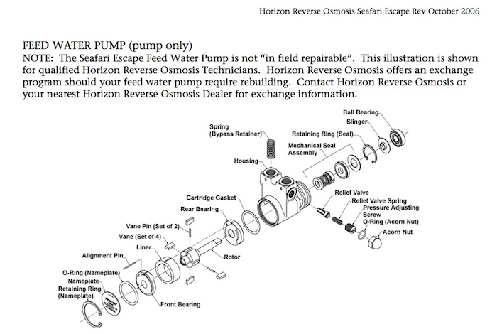

    I could not open your picture file. Thanks anyway for telling us that you once got a reconditioned pump for free from HRO. If they knew already then it was a "250 hour pump", did they not suggest to upgrade to the vane pump?
    In 2006 the vane type seems to be the one and only feed pump for all their systems, so I doubt they at that time were delivering new systems with pumps they knew should fail after 250 hours..?
    http://www.artimarin.com/PDF/Seafari_Escape_Owner_Manual_Oct06_web.pdf

    Thank you AMG for the post and Sea Recovery archive drawing!

    That pump is "field repairable" in about 30 minutes on the galley table with probably just a change of "liner" and vanes.

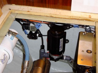

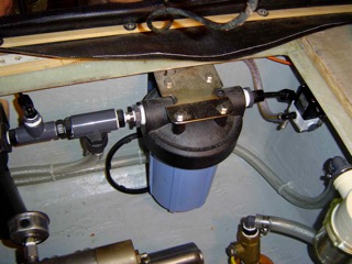

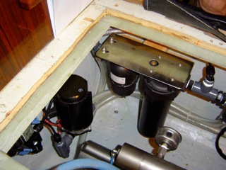

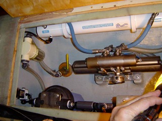

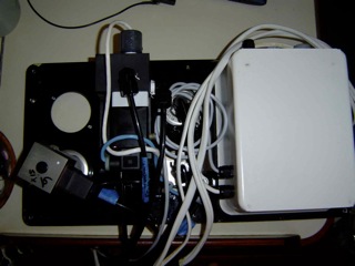

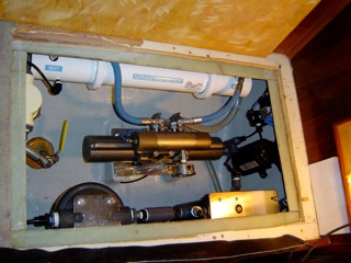

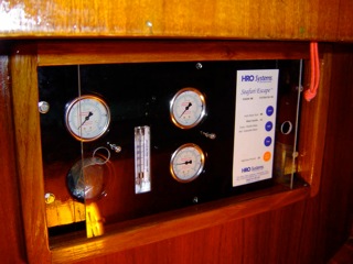

    Here are the photos he was trying to upload, the ETD thing has me the most interested, how can a diaphragm pump supply enough grunt to push water through the membrane?
  6. K1W1
    7,453
    Here are some more

  7. Marmot
    Marmot Senior Member
    May 20, 2007
    3,300
    9114 S. Central Ave

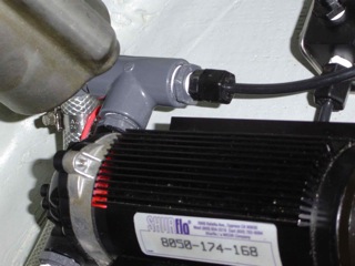

    That is a Procon PD pump. Here is where to get the repair parts. It is up to you to find room on the galley table.
    Procon Pump Parts - Dultmeier Sales
    Here's the manufacturer's data:
    http://96.61.63.50/techlib/Procon/Procon_Pump_General_cat_D603.pdf
    Google Procon and you will find all the technical information you need to maintain and repair the things. This is not rocket science as much as the supplier would like you to think it is.
    K1W1, the "ETD" is what makes the high pressure. It is an "intensifier" just like used to boost shop air up to high pressure or to use shop air to drive a hydrostatic test pump. It uses a large volume of low pressure fluid to create a small volume of high pressure fluid.
    We used a similar hydraulic powered unit as a high pressure ballast pump on deep diving submersibles down to 2000 meters.
    I suspect that the diaphragm pump is used elsewhere, if it is used as a "boost" pump then that explains why the vane pump died so early. A vane pump with any kind of a suction head will destroy itself rapidly due to cavitation.
    Looking at those pictures, it appears that the Shur Flo is used as a "freshwater flush pump." Unless the flushing check valve is leaking because of debris from the PD pump vanes and is over pressurizing the diaphragm, it should last forever as it gets less use in that application than it would as a potable water pump in a small boat.

    One issue to watch for in some installs, are those zip ties chaffing thru hoses. I don't really see many here but when beard marine installed our 900 GPD modular, the installer tightened Some if the zip ties too tight on some of of the thin nylon tubes used to send feedback to the unit. Over the last 4 years, 3 have sprung leaks resulting in the loss of one Air con pump. The other 2 were caught in time when a bilge pump came on. Major PITA to check and correct all the others scattered around the ER.

    Interesting the similarity between the image in section 9; page 8 of 54 (page 212 of 266 of PDF) of the above link from AMG's post and the image on page 6 of 45 of the second link from Marmot's post.
  11. Old Phart
    Old Phart Senior Member
    Mar 14, 2011
    1,327
    I dunno
    The Nameplate in both images are amazingly similar.
    Is HRO and Procon the same company?

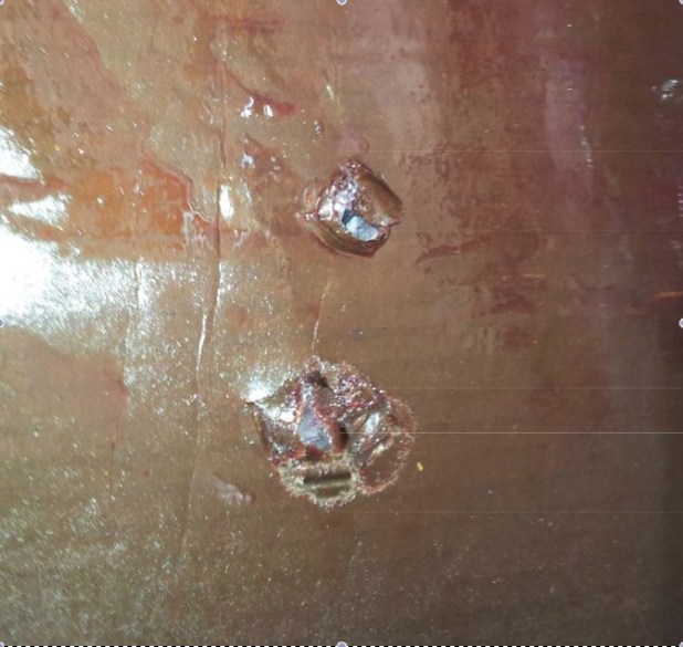

    Thanks AMG.... there is another photo not in this series that shows the box perforated by the pump... a close up. In the series you can just see it: 2 holes in the side of the box. In the close up you can see the pump thru the holes.
    Per the post by 'Capt J' earlier in this forum : I think we can all agree that if you had just spent $2150.00 of your own money you would expect an exchange. You would not be happy accepting this result.

    Hi Marmot; Thanks again for taking the time. The Shurflo Pump in the Image is the Sea Water Pump supplying the ETD. These are the Diaphragm pumps Sea Recovery supplied that I have been writing of. Doomed to failure after about 250 hours.
    The Fresh Water Flush is supplied by the boat fresh water pump in the engine room and plumbed to the water maker compartment in the photos.
    There is NO vane pump in this system. There is no boost pump. Just the diaphragm pump feeding the ETD.

    I have uploaded the close up image. As you see the box has been perforated.
