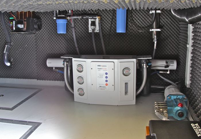

    I am a little confused on what kind of pump you got as a replacement now. Is it another one that you expect to break down, regardless of the transport event, or is it a better one?
    The reason I ask is that we recently delivered a boat with a HRO Seafari Escape, does yours look like this one?

    Thank you very much for taking the time to post this. Yes.. the NEW pump we ordered is the same beast you have in the picture. The motor is different, but the pump head looks the same.

    The CAT pumps have a breather. You can see it in the photo posted by AMG above. It is the red 'cap' looking thing. The breather did just that: it let all the oil out because no handling instruction were placed on the box i.e. 'this side up', 'fragile', 'oil enclosed'.... etc. The oil was not shipped in a separate sealed container. It was not listed on the packing list. There was no "international transit sheet" (as you wrote) or other document notifying the carrier that hydraulic oil was in the package.

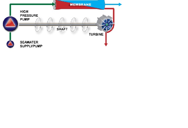

    You talked about a Shurflow Diaphragm Pump first of all now you are saying the oil leaked out of the CAT HP Pump.
    Which is it?
    The ETD Process seems to be pretty straight forward if it is as shown in this picture.
    If it is just the Low Pressure Pump that is gone stop bashing your head against the wall and just replace it with a pump suitable to do the job.
    You could also make you life a lot simpler by re using things that are still ok on your existing POS and get a machine knocked up using off the shelf parts.
    Water Makers are no great mystery, it is just the increase in automation that has made them look frightening and difficult to understand for most folks.

    Thank you K1W1 for the poste and I'm sorry if it seems I have confused the issue.
    The information re the Shurlfo pump and the CAT pump are in the original poste I placed and in subsequent postes to other forum members.
    To summarize very briefly: The machine was sold by Sea Recovery with the Shurflo diaphragm style High Pressure pump. After about 250 hours this pump's performance started to drop because of deformation and degradation of the valve and diaphragm materials. Just 250 hours after spending $11,000.00. This is the problem.... Eventually and after much one sided debate from Sea Recovery we made the decision to buy a pump from them that would perform/last longer: the $2150.00. CAT/Plunger pump. At the time we did not think we had any other choice based on what Chris Rollins from Sea Recovery had disclosed. The shipment of the additional 2150.00 purchase was a disaster: the machine was packaged very poorly and arrived damaged.
    Hope that clears up any confusion a little bit.
    No one expects after spending $11,000.00 on a watermaker to only get 250 hours. 'Insult to injury' is being told you will have to spend another $2150.00 to get a more reliable pump. Sea Recovery knew before the sale that the diaphragm style pumps would not last long but did not tell prospective buyers of their systems. A BIg omission....
    Thank you very much for taking the time to supply the drawing and advise.
    I believe that based on comments from you and other forum members we have a solution that will get our machine working using NON Sea Recovery supplied parts.
