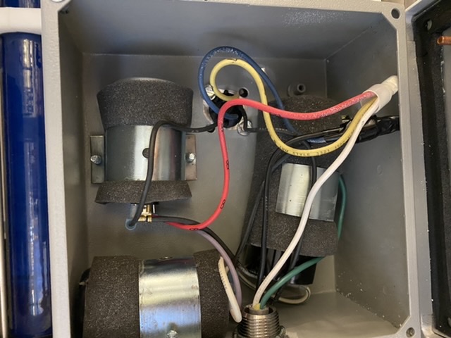

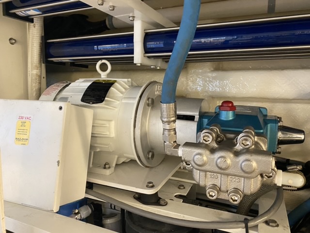

    Brand new high pressure pump with less than 3 hours run time. Baldor 240v motor on a 2400 GOD sea recovery.
    Pump hums, doesn’t build any pressure and turns pretty slowly when observing the coupling thru the mounting flange. I can hear a change in sound from the generator. If left on for more than a few second, it shuts down.
    I uncoupled the pump from the motor. Pump turns fine by hand with as one resistance but it s not seized
    motor spins up fast without the pump.
    I am wondering if one capacitors isn’t bad. There are three capacitor in the box. Never tested any and before following some directions found on YouTube I figured I d ask here. Yes I have a fluke capable of reading uF
    of course this happens on day two of a month long trip to the Exumas... not quite dead in the water as right before leaving I listened to that little voice and installed a back up 800gpd SeaWater pro.

    R U sure it isn't a 230V 50Hz motor?
    I can't read all the yellow label on the box, but it does show 230VAC at its top.
    Anyway, the symptoms you describe indeed suggest a bad running (not starting) capacitor.
    Not sure of why there should be 3, though.

    You might be unable to spot a defective run capacitor with just a multimeter.
    Easier to just replace it and see what happens - it's not a big investment anyway!
    If you pull the capacitors out of their brackets and post pics of their labels, we can see who's who.
    Don't forget to discharge them, after detaching the wires!

    I pulled the two capacitors and tested them. They re both within acceptable range 229 MFD range 216-259 and 40 MFD range 40 MFD +- 6%
    The third thing in the box isn’t a capacitor but a switch.

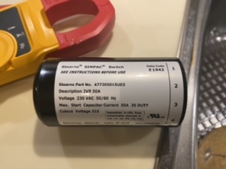

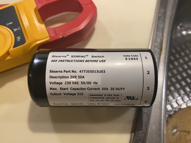

  15. Pascal
    8,942
    I posted a picture earlier but low res and hard to read the label. It has four terminals which are connected to either capacitor and one line in. Here is a clearer picture.
    I know issues rarely fix themselves :)
  16. Capt Ralph
    14,562
    Like a compressor, a start relay. Just it looks like a cap in that bake-light package.
    https://www.witmermotorservice.com/477205015U03-Stearns-SINPAC-Electronic-Switch/item/2VR50-310
    Amazon had them.
    If the motor starts, don't turn it off.
    Ease up on the pressure to reduce noise and ACv current draw, just don't turn it off.

  19. mapism
    mapism Senior Member
    Aug 9, 2008
    2,296
    Sardinia
    And didn't he mention that a multimeter test with no load on a capacitor is as reliable as tossing a coin? :confused:
    Based on your latest findings, two things are clear and another remains a question mark:
    The two clear things are that the motor is fine, and whenever it doesn't run it's due to a faulty electrical supply.
    The question mark is about whether the culprit is the run capacitor or some other parts of the circuit, like the switch you mentioned.
    Now, I have no clue about what that switch is for and how it works, but the 40 MDF run capacitor (which I envisaged to be defective already in my post #3) is something I could buy for less than 10 Eur in any electrical store here, so I'd be surprised if you couldn't do the same anywhere in the US.
    In other words, it's a no brainer - just replace it and chunk the old one in the garbage. I bet that the problem will not reappear.
    Of course, if instead it would, you should look into that switch first, whatever it's meant for.
    Hard to comment that without an electrical scheme, though.
