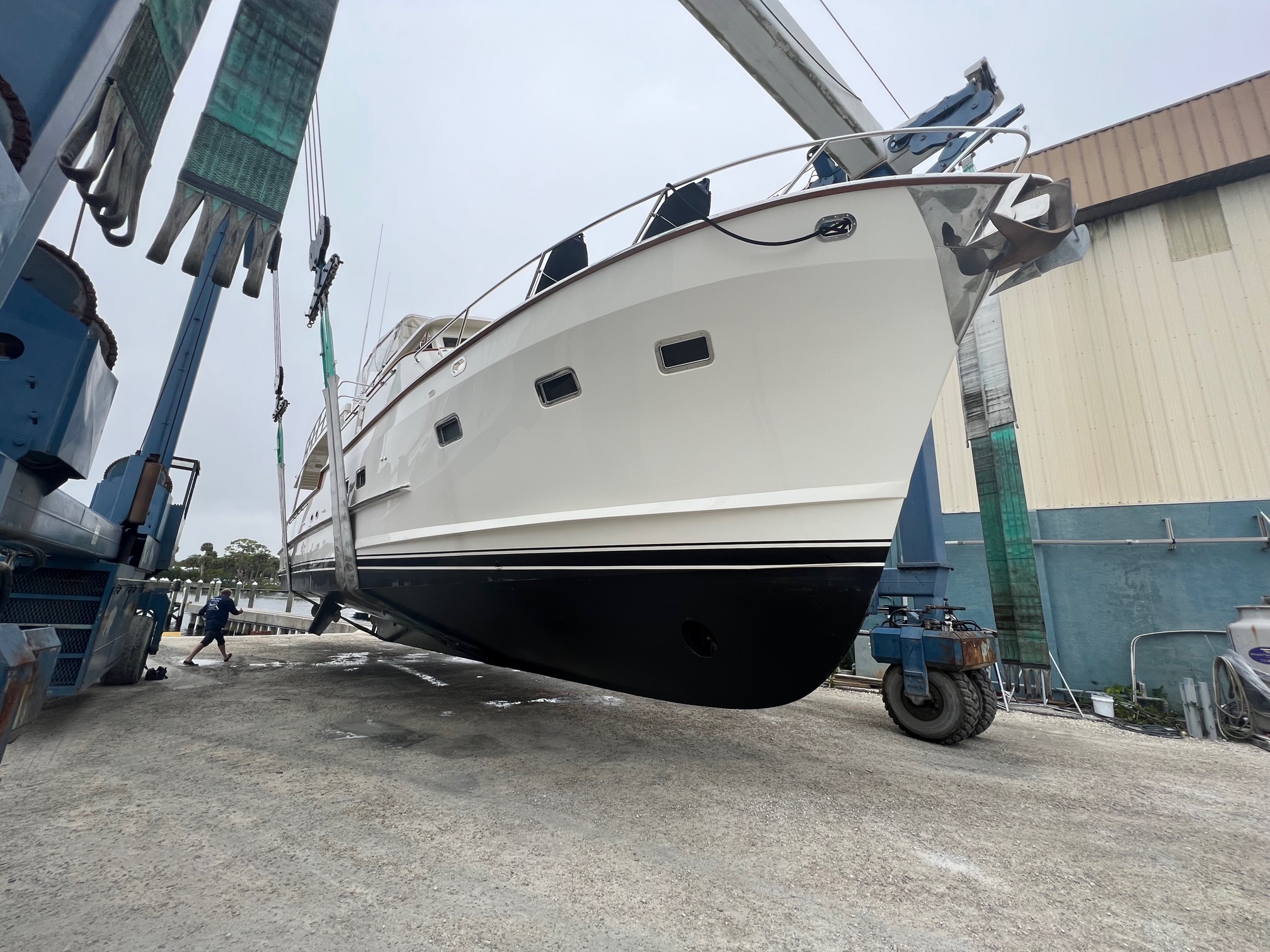

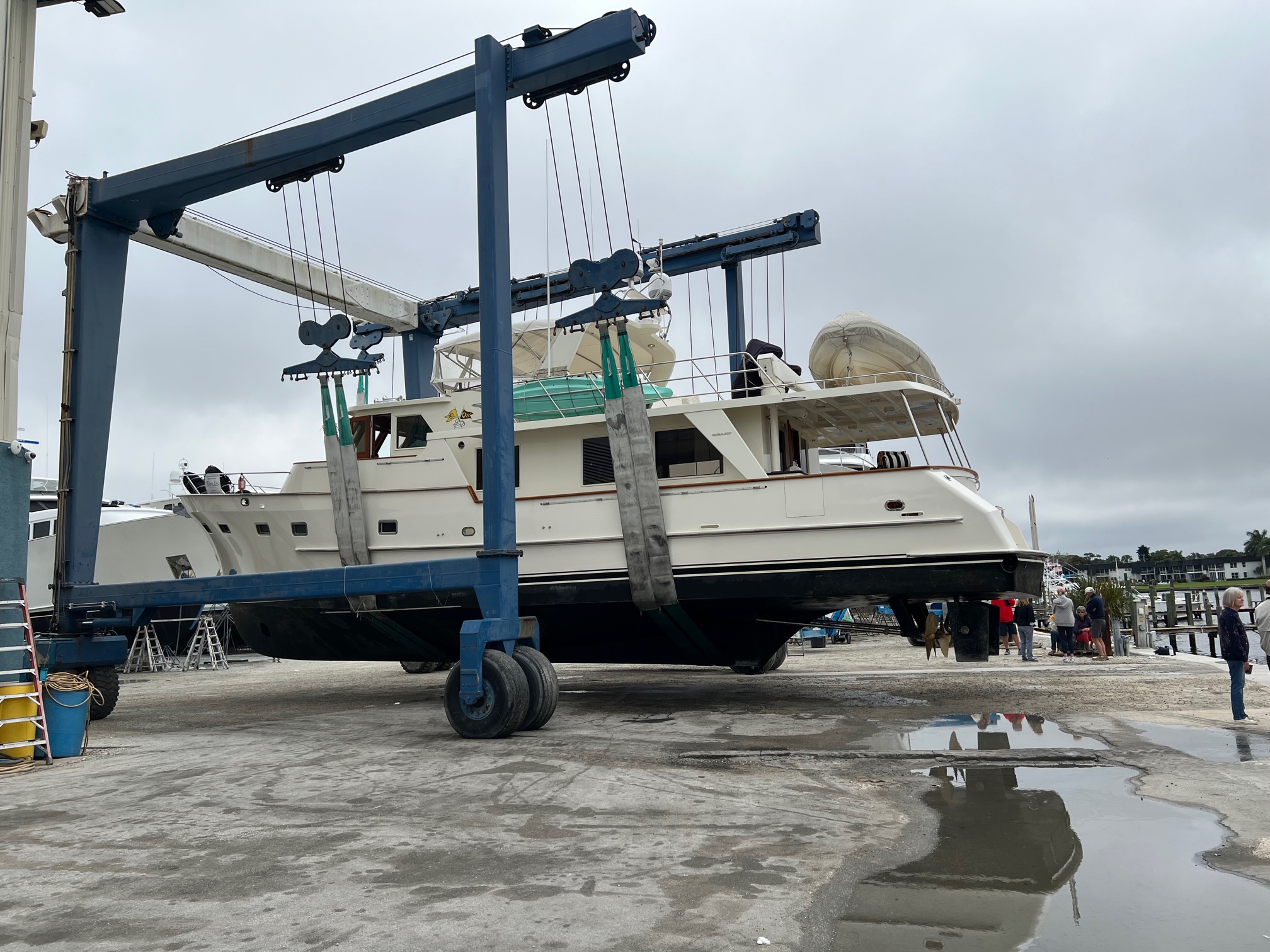

    Thanks everyone for your seasoned advice on these two issues and for the information regarding Grand Alaskan. As an update, the survey indicated that there is a possibility it could be the fins, as the worst off the vibration is just about over where they are located. IMG_0350.jpg IMG_0345.jpg

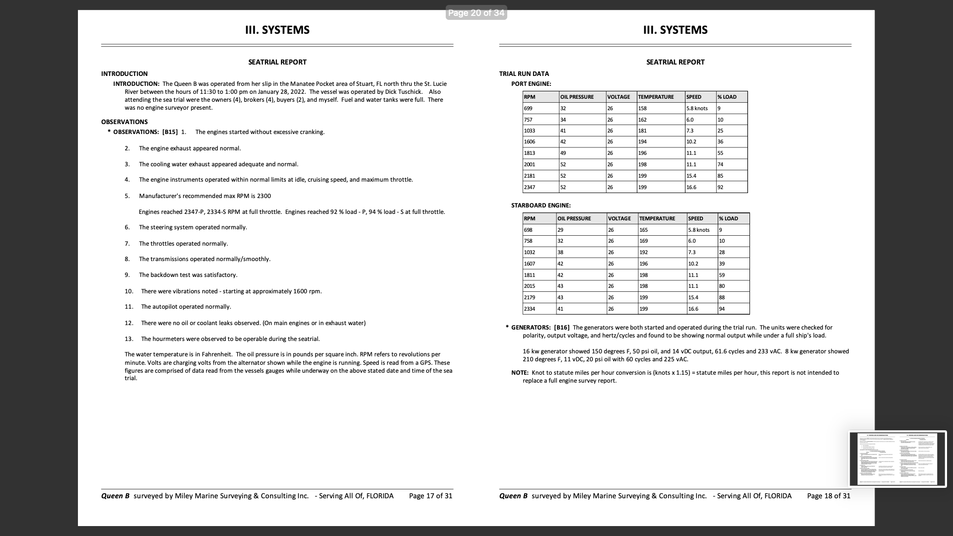

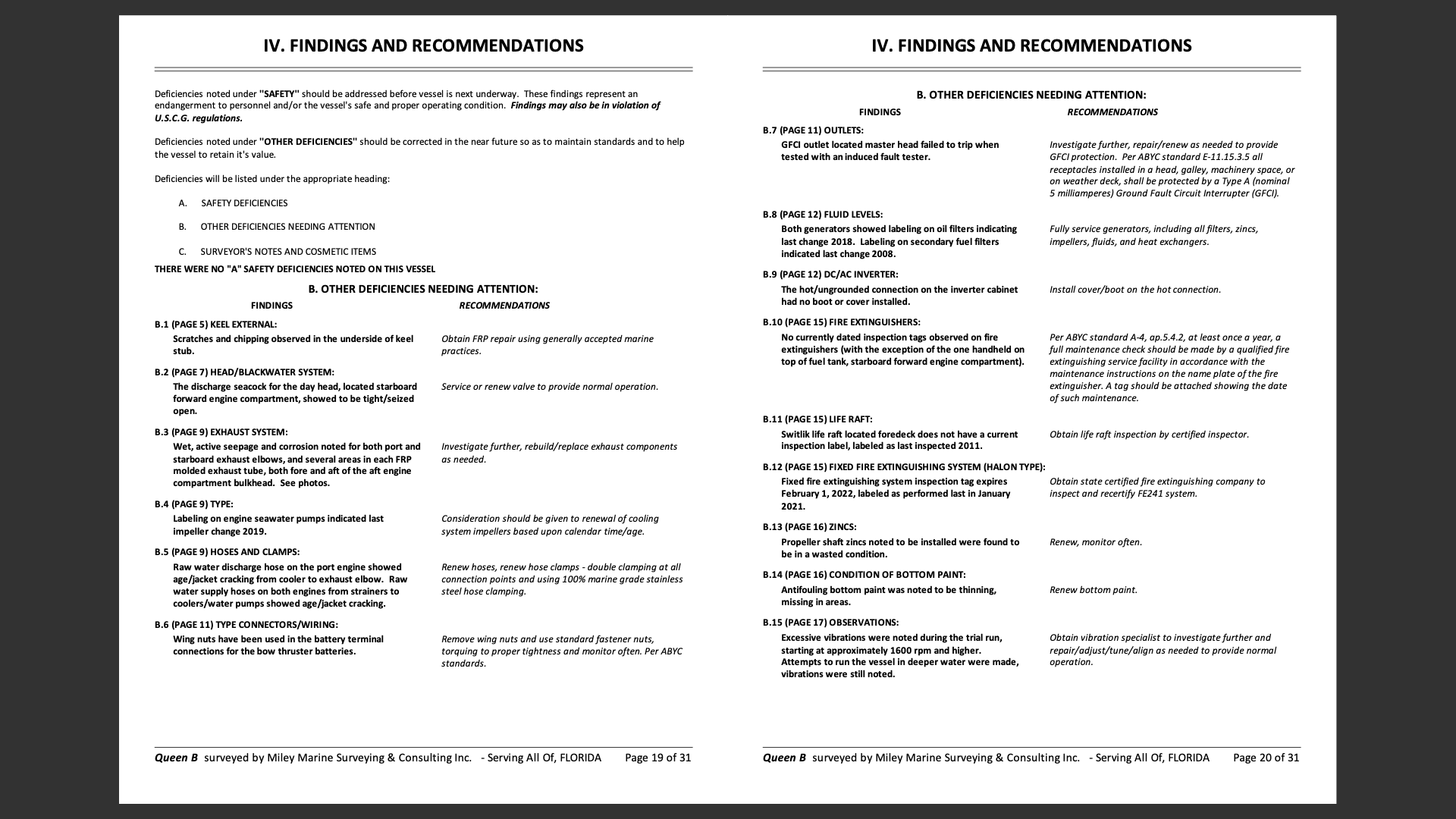

    Great advice from all thank you. I got the survey back today and thought I would share a screen shot of some of the finding.
    Screen Shot 2022-02-03 at 7.45.34 AM.png Screen Shot 2022-02-03 at 7.45.41 AM.png Screen Shot 2022-02-03 at 7.45.48 AM.png Screen Shot 2022-02-03 at 7.45.57 AM.png Screen Shot 2022-02-03 at 7.46.04 AM.png

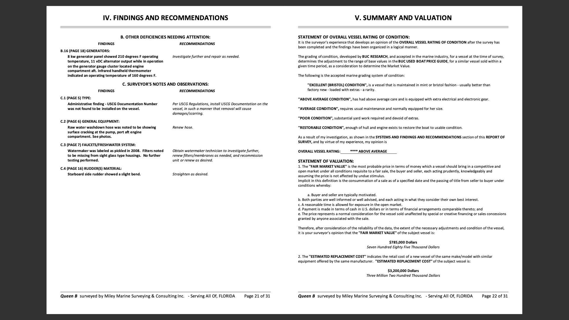

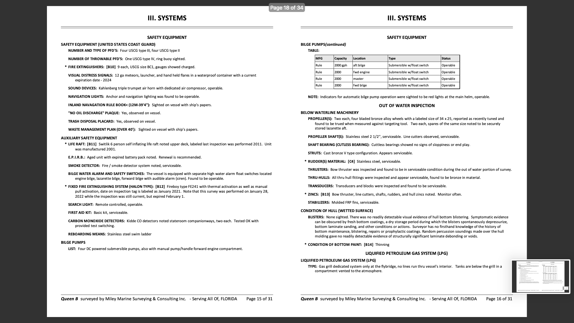

    Here are some pages and recommendations from the survey.
    Screen Shot 2022-02-03 at 7.42.02 AM.png Screen Shot 2022-02-03 at 7.41.40 AM.png Screen Shot 2022-02-03 at 7.41.37 AM.png Screen Shot 2022-02-03 at 7.41.34 AM.png Screen Shot 2022-02-03 at 7.41.15 AM.png

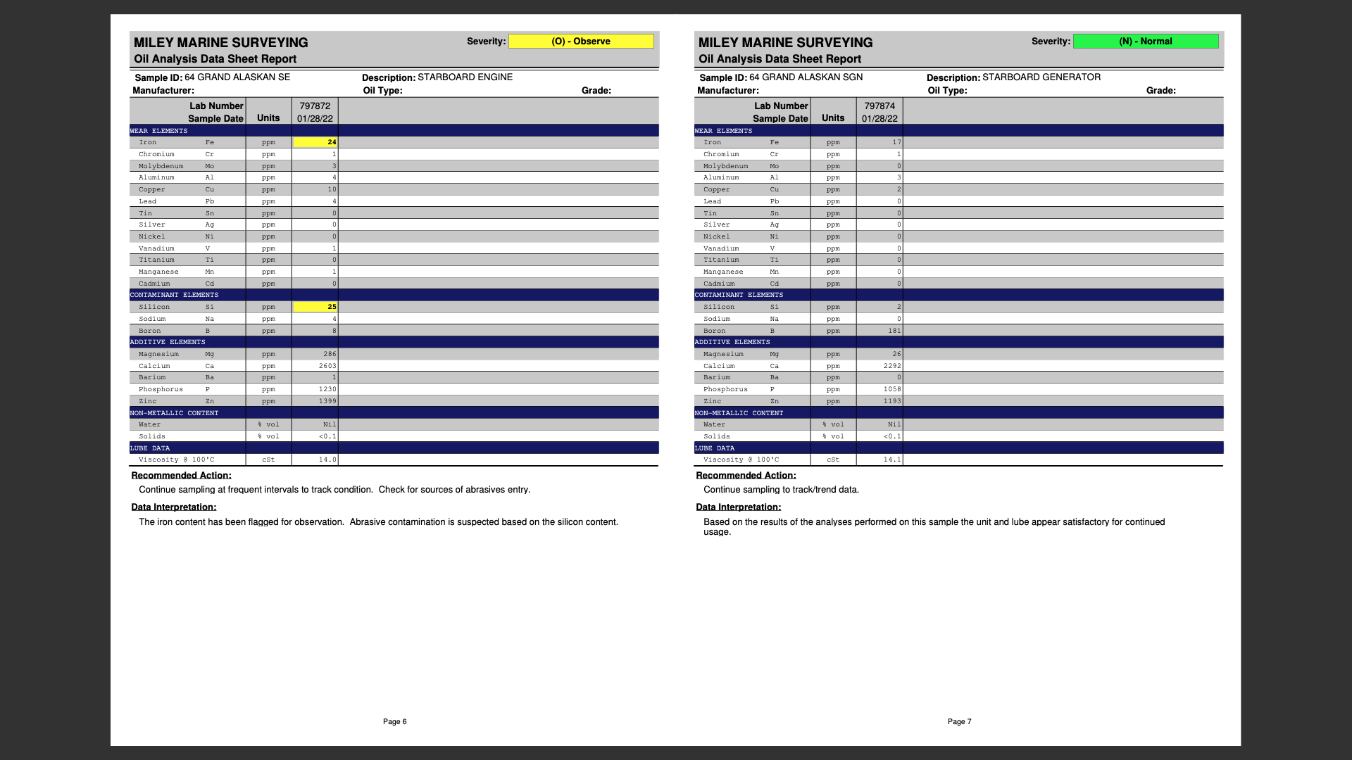

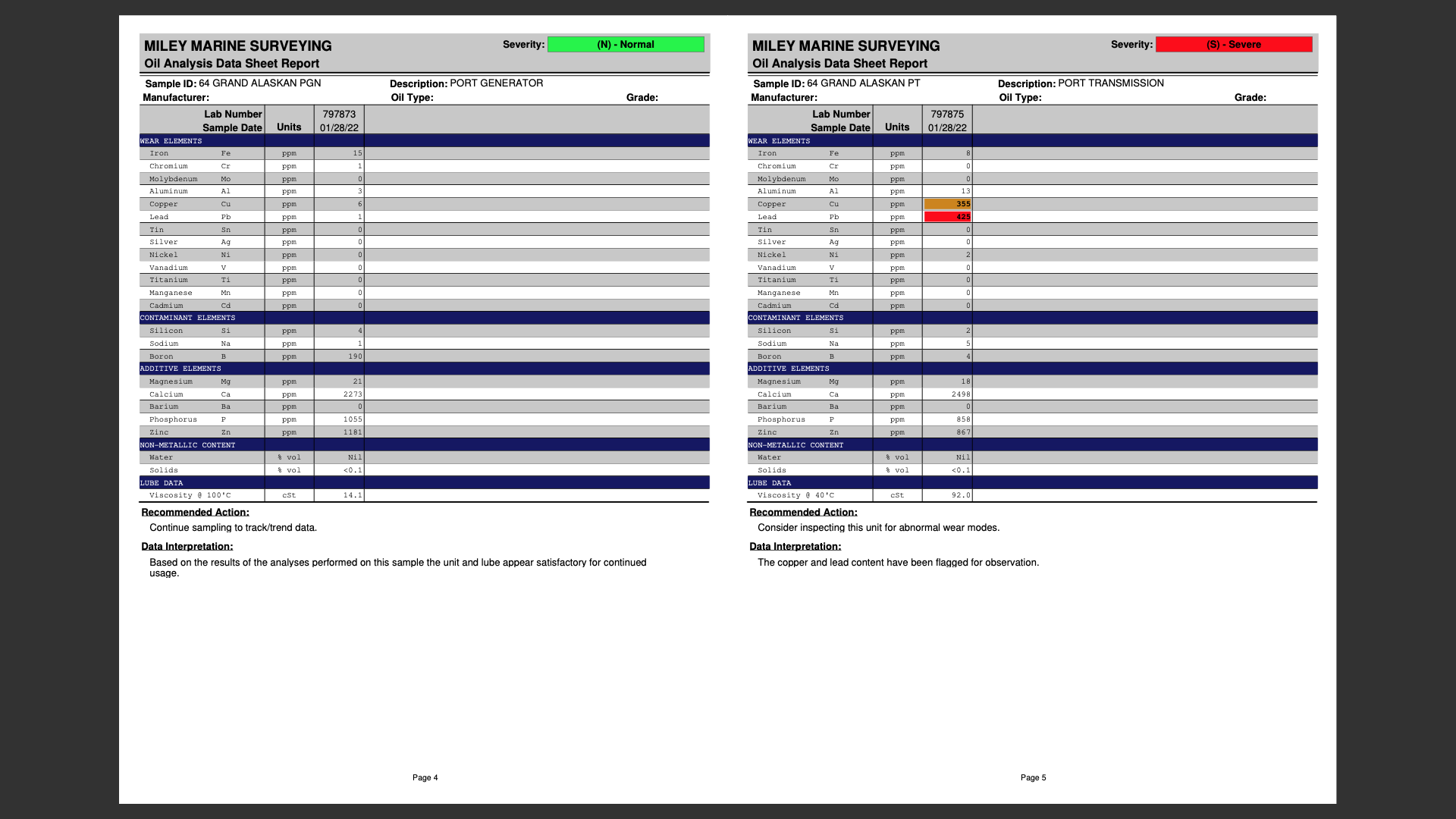

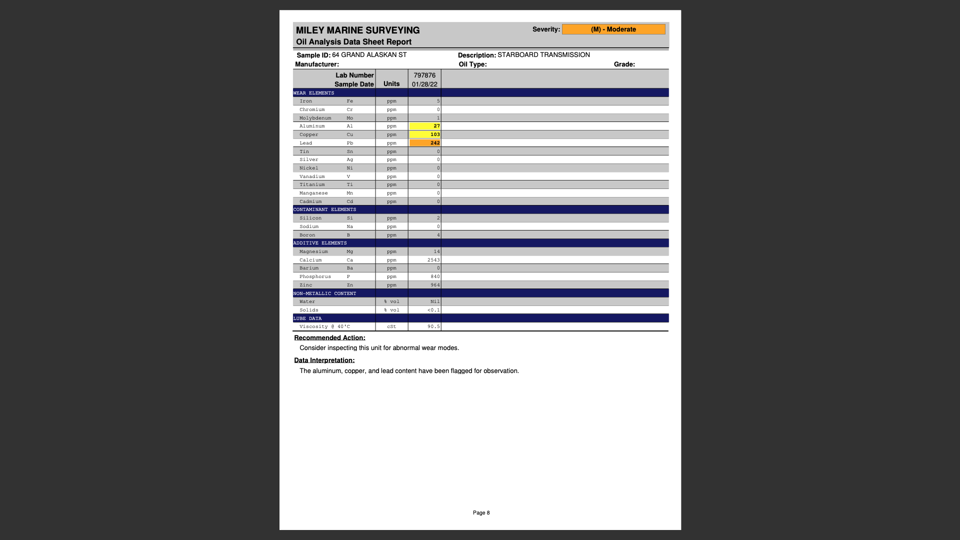

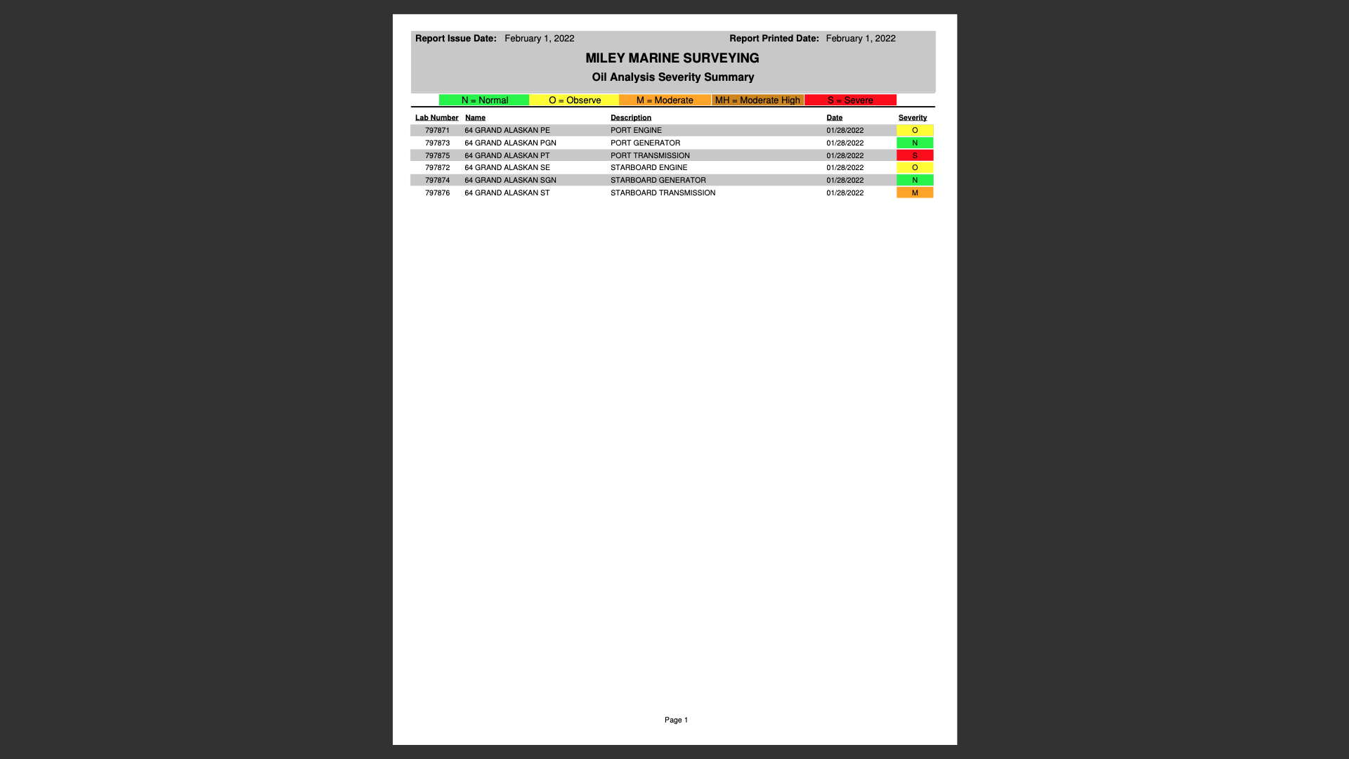

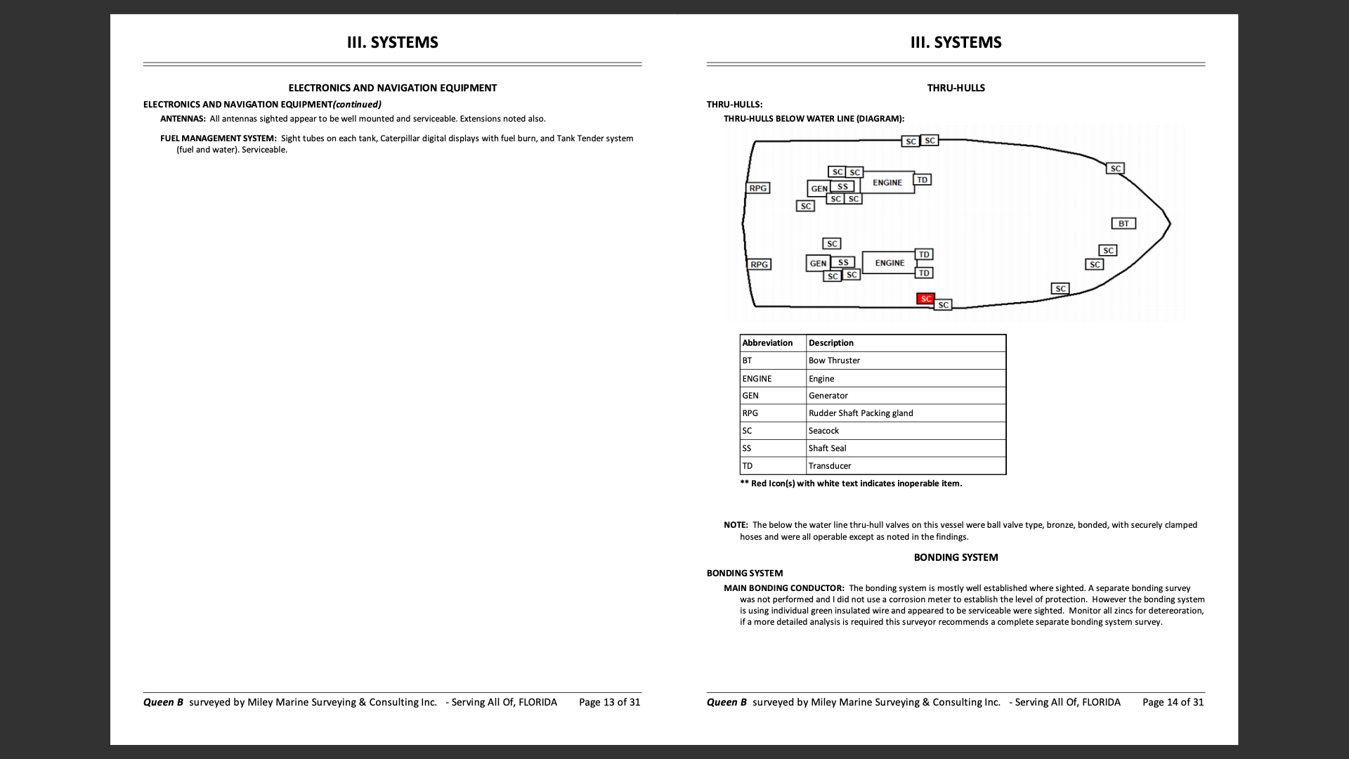

    A few more
    Screen Shot 2022-02-03 at 7.41.07 AM.png Screen Shot 2022-02-03 at 7.40.59 AM.png Screen Shot 2022-02-03 at 7.40.52 AM.png Screen Shot 2022-02-03 at 7.40.42 AM.png Screen Shot 2022-02-03 at 7.40.32 AM.png

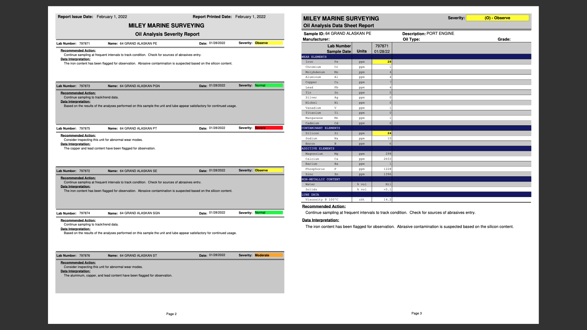

    Some of the visible stuff in that survey like the exhaust issues alone would have stopped me from even going to survey and wasting money.
    these are not just scratches on the keel... they re heavy gouges. Wth did they hit??
    i m no expert in analyzing oil analysis reports :) but too many red flags there as well.
    and the performance is just awful. This is not even a fast trawler it s a trawler
    some of the issues like performance (or lack of) and exhaust leaks point to build quality issues. Others are lack of maintenance and care. Who puts a boat on the market with an overheating generator and cracked leaky exhaust?
    there are some things that only a survey will reveal but this is not the case here. I would recommend that you hire a experienced captain to preview the next boat you will put under contract and have him present for a pre survey sea trial. It will cost you a few hundred bucks but could save you thousands in survey costs

  20. motoryachtlover
    motoryachtlover Senior Member
    Jan 29, 2007
    760
    smithfield, VA
    Not as a disagreement to any of the above about walking away or putting burden solely on Seller to remedy all major issues prior to further negotiations. But I thought I would mention the following for the benefit of others. I recently read about an oil analysis lab that had erroneous samples due to improper cleaning between samples. I cant find it after a short search. I am older but not demented. I know I read it as that same lab gave me to red flags for elevated copper on both engines. Also while I agree to take samples upon survey I think that one shot samples are subject to a lot of interpretation. I annually sample my oils and have had yellow readings that concerned me only to be told by mechanics to ignore it and keep running. I have been told that Man does not have any specs on iron, copper, etc for oil intervals. I think I am describing that correctly.
