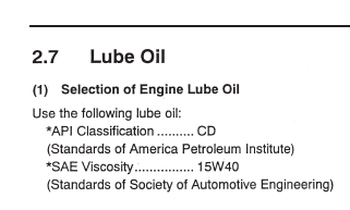

    First time doing an oil change in my Yanmar 6CXM-GTE2.
    My last boat had flat tappet cam, so I used a Zinc additive to protect the cam.
    Do I use it in these engines?
    Are they roller cams?
    Thanks in advance!

    I contacted Yanmar... great response.. they said no additives..
    Cheers!

    I did extensive research on the zinc content 2 years ago and came to the same conclusion Yanmar did - no additives, current Diesel oils from Shell and Delo have 1500ppm plus zinc in each. I didn't do this for Tres Leos with her 6LP Yanmars, I did it for Southern Exposure with her Crusader 7.4L BBCs. As a result, I run Rotella T1 SAE 30 or 40 if I can find it in the gas burners because the zinc content is about as high as you can get without using break in additives.

    I heard from Yanmar, the Napa oil is fine, no additives....
