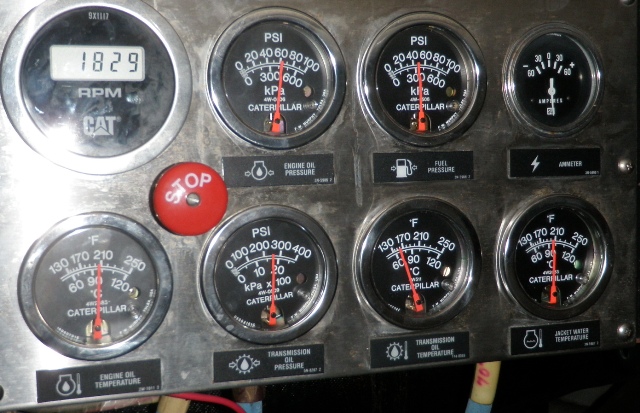

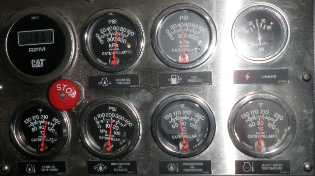

    Pictures from Sea Trial After Cleanning inlet for Engines
    Hello My friends, I clean the seawater inlet from engine, It was very dirty, I take them out clean them and clean the inlet, put them back, run a test, no improvments neither Engine or Transmission Temperature...
    There is Something that it is bothering me.....the port transmission pressure is electronically in 240 and manual in 200, I already clean the transmission filters (no improvement).
    it is any way to increase the pressure of the transmission?

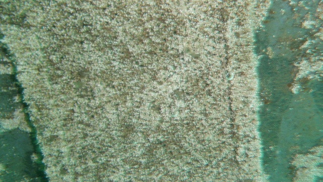

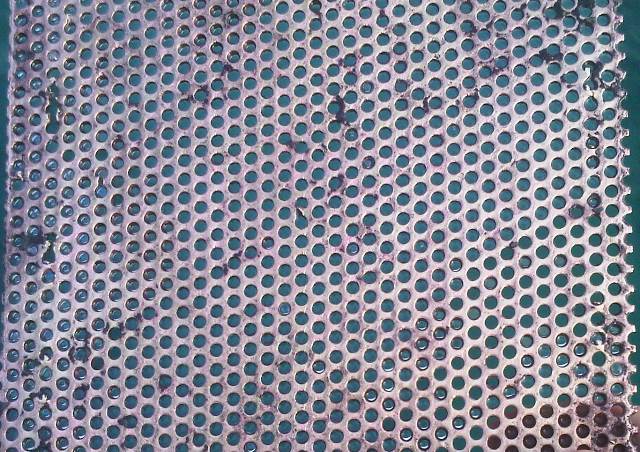

  9. zappiros
    zappiros New Member
    Nov 6, 2008
    57
    Bonaire, South America
    Strainer Inlet after clean
    I cleanned with on-off hull cleanner and remove barnacles....on each individual hole....very...very...! time consumming :)
    But below is the result :):):)
