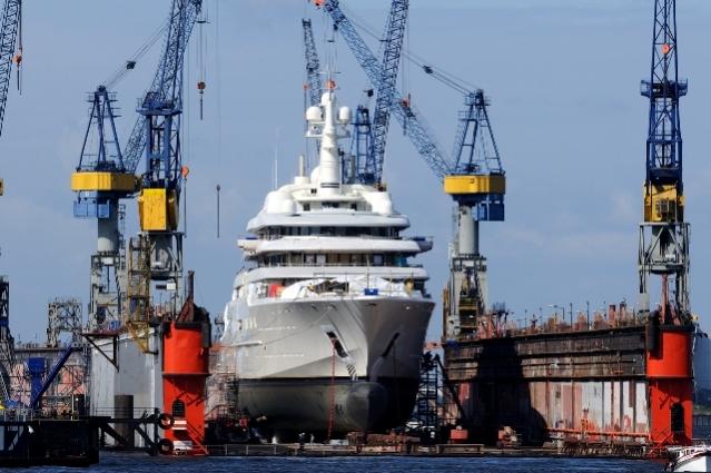

    KIWI your a correct, they take some internal volume for their pockets. And you got me on these Quantum stabilizers. I saw them, when I walked through the floating dock at B&V with Eclipse in it but I did not really noticed them and later forgot to ask.
    Are these the onces that can be seen on this picture of Ecplipse in dock ? How effective are they in comparison to the retractable fins? When I remember correctly, Eclipse had four of them.
  13. K1W1
    7,435
    They have been shown to be much more effective as they are always moving.
    The biggest drawback with them is they are limited to a top speed of somewhere around 16/17kts.
    They have shown themselves to be particularly effective at no and slow speeds that a lot of patrol boats are tasked with doing these days.
    There is no dead period when slowing down in the anchorage and they will also work when going astern - something that no fin will do as far as I am aware.
    They also do not make the vessel tend to swim around as they operate at anchor.

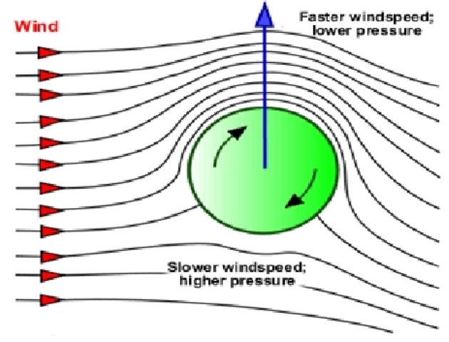

    Retractable stabilizers extend backwards towards a mechanical stop and held open by the flow of water. The faster the ship goes, the smaller the movements of the fin, same as on rudders on aircraft. They are strong enough for higher speeds and still work at higher speeds but only in one direction because of its hydrodynamic profile.
    The principle of the new Quantum MAGLIFT retractable stabilizers is based on the "Magnus effect". Which means, the air flow around the side of a rotating cylinder, which rotates with the flow, is greater than on the other side causing a slight pressure difference. This creates lift. This phenomena is used for roll stabilisation. In addition, besides its bidirectional rotation, the cylinder moves forward and backwards during its rotation to create this kind of lift during zero speed situations.
    But this effect will die during higher boat speeds and the cylinder will only have an symmetrical flow around it, the lift will be destroyed within the boundary layer and because of its head resistance, the extended cylinder gets counter productive and it is better to retract them. When you look at the animated videos, it seems funny, how this cylinders paddle around during their zero speed work but they really seem to work.
    I do not believe, they have to be retracted, because they are unable to withstand the waterpressure at higher boat speeds but because of their greater angle of movement beyond the rectangular position, they have to be positioned by hydraulic force and not by a mechanical stop.

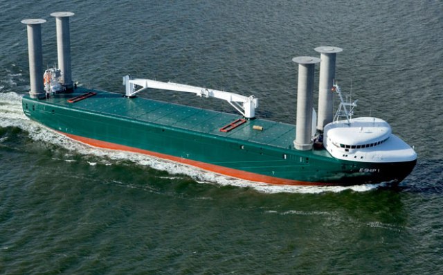

    The vertical Flettner Rotor (for example used on the E-ship 1) uses this Magnus Effect to add in propulsion of a ship. The fuel saving have been up as high as 25 %, using these rotors on that cargo vessel. But on this vertical rotors, big endplates (like winglets on a/c) increase the effiency remarkably. These endplates would not work on the stabilizers because of their additional freedom of movement. The above mentioned Magnus effect should not be mistaken with the Coandă effect, which is far more complicated (to explain) in the 3D world.
    I hope, my limited command of the english language could explain this complicated subject a little bit.
    Magnus effect:
