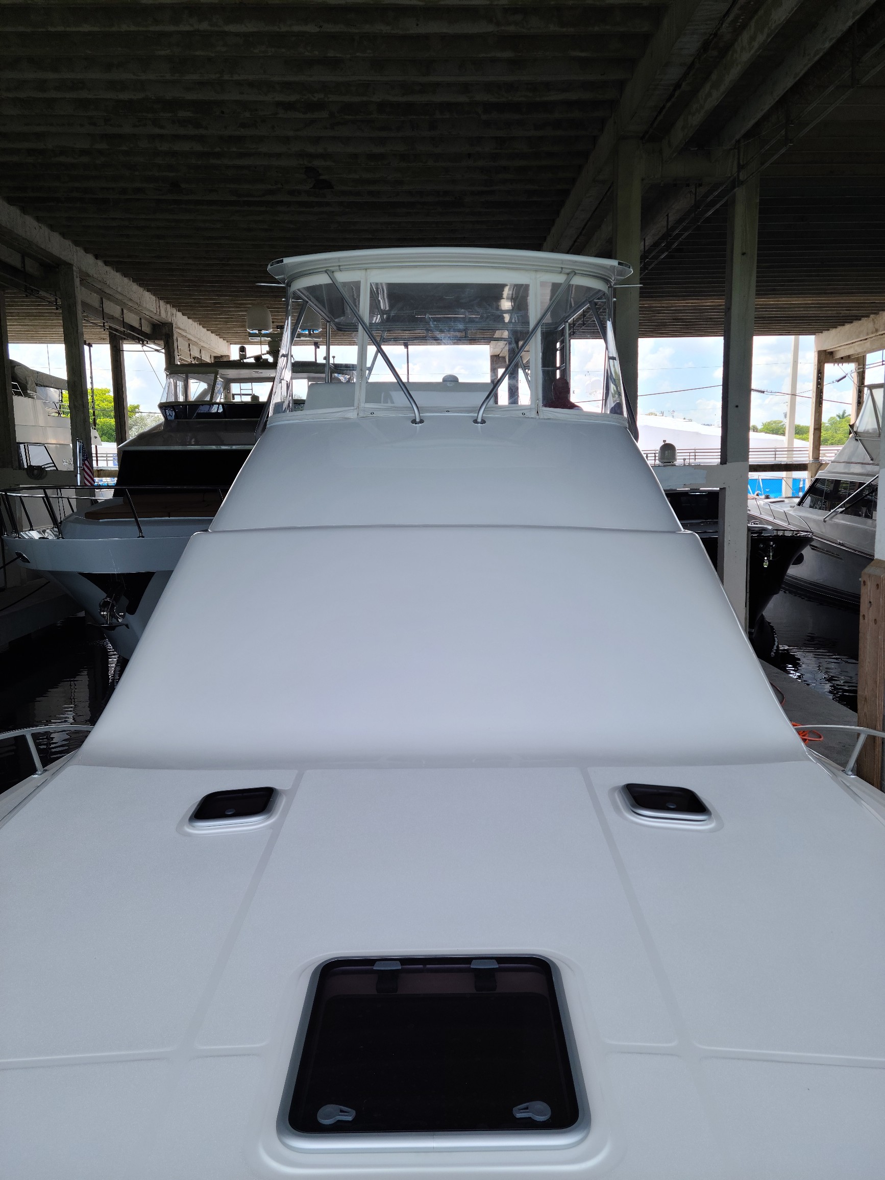

    Put the temporary enclosure up today that should help on the bridge assuming we load bow fwd. Have new console cover being made that will go on tomorrow. Probably leave new helm chairs in the salon for the trip.
