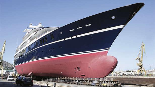

  19. K1W1
    7,453

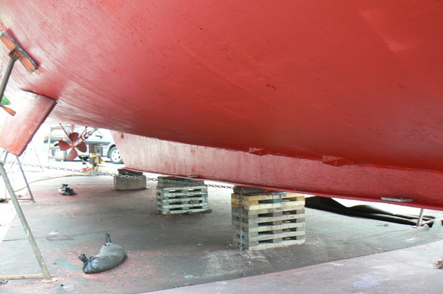

  20. dennismc
    dennismc Senior Member
    Jan 29, 2009
    1,180
    Vancouver BC
    Here is a pic of the stb'd stabilizer on my 70 ft Aluminum Stephens, is a Vosper maxi fin and above the keel bottom Stab.JPG does not project beyond the hull sides
