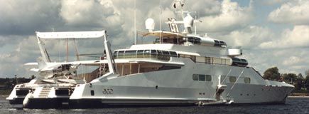

    Are there any yachts that have just used a small seaplane that could be lifted and swung on board?
  6. AMG
    5,392
    Yes, I know at least three and Golden Shadow had a Cessna Caravan onboard...

    Blohm & Voss Eco
  9. Ralph Holiman
    Ralph Holiman New Member
    Apr 27, 2017
    33
    Mississippi
    That definitely looks like a better way to go.
