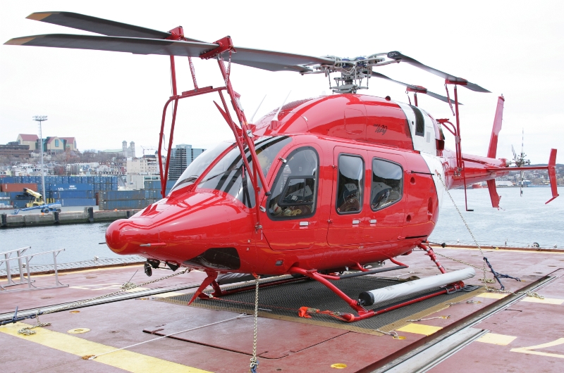

    Back when I was in a navy they had a special eccentric wheeled jack based thing that they would roll under the (Bell) helicopter and between the skids, hook into matching notches and then push down thereby lifting the whole helicopter as if it were nothing. The helicopter could then be moved around on the jack's wheels.

    Navatech, I did not mean to imply that a heli with skids could not be moved, simply that a heli with wheels is probably going to be more straightforward to move. A jack of the sort that you mention is large and heavy. If you have another heli fly in the jack is just in the way too.
    There are tradeoffs to every choice.

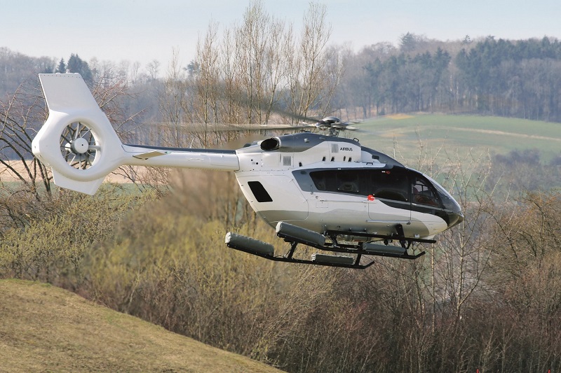

    Perhaps this is not the best thread to write this but Luviar, the company that manages Mr. Abramovich helicopter fleet announced a 'fleet renewal programme': they've acquired two Airbus Corporate Helicopters (ACH) 145 and one ACH 160. One ACH145 was delivered already, the other one will be delivered before the end of the year and the ACH160 will be delivered after the certification process.
    Both ACH145's exterior and interior are designed by Harrison Eidsgaard. Below is the photo of the first one (register is M-SOLO), taken from Airbus website:

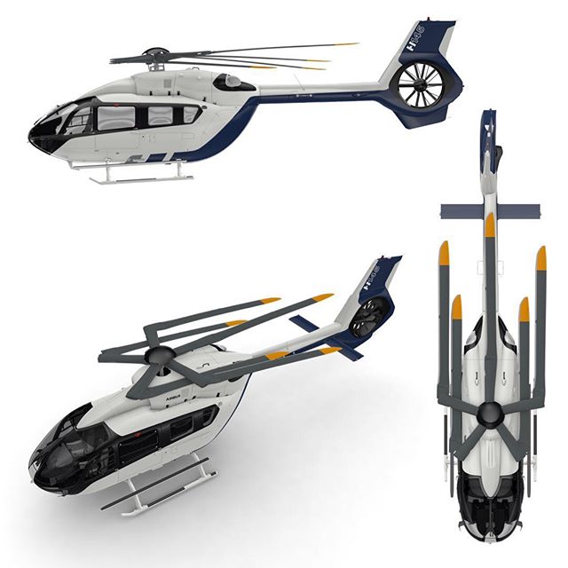

    I really like the H145 T2. The really new ones have a 5 bladed rotor head, although I am not sure they can be folded like the old 4 bladed versions.. Taking the blades off is a bit of a pain.

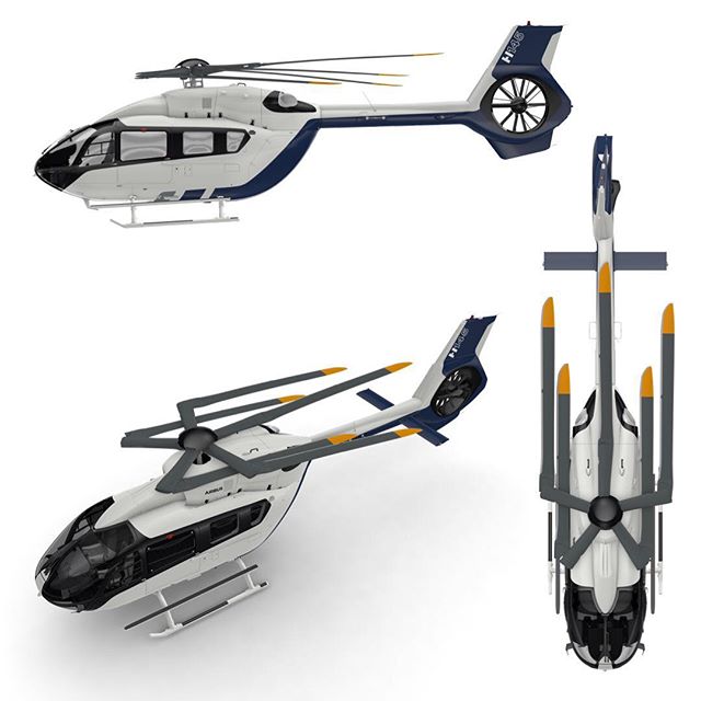

    The 5 bladed rotor head is a dramatic improvement for the H-145 / ACH-145. Less rotor diameter, 150 kg more payload, higher cruising speed, higher HOGE and most important, the blades are vere easily and quckliy foldable. The much smaller footprint of the H-145 with the new 5-blade rotor folded is just equivalent to the size of the hull.
    Together with the much safer Fenestron, this new rotor makes the ideal light twin turbine helicopter for the use on ships or yachts. I cant hardly wait for the upcomming the delivery of our first H-145. As the 5-blade rotor is still under certication, our (AC)H-145 will be delivered with the extended emergency flotation skid gear and the larger ground mapping radar nose plus removable cargo hook but still with the standard 4-blade rotor. As soon as the 5-blade variant receives the EASA certification, the new 5-blade rotor will be retrofitted. This retrofitting possibilty was very helpful and decisive for the buying decision. We will fly it in the 2+6 seating version (cockpit plus 2 x 3 club seating).
    During my type rating course for the H-145, I was allowed to have a flight with some stick time in the company demonstrator, which is used for the certification campain. The main trick on this new rotor is the separation of the flex beam (the inner not foldable part of the rotor) from the rotor blades. By just pulling one of the two bolts, the blades can be follded in a specific manner. It took even me only a few minutes to fold the blades and vice versa. Folded, it takes less hangar space than a Robinson R-66.
    As my present boat has no helo landing pad, just some winch only spaces, we will use it only to land on the shadow. With the size of that landing pad, even me will not have any problems with regular ship landings.
    In the past, I was very hesitant to talk to the sales people from Eurocopter, as they had rather limited interest in the private customer but the business helicopter department of Airbus Helicopter is much more interested in us private and normal mortal customers :).
    Sorry, but our present Bell 407 ist not fighting in the same league.
    Will post more pictures, as soon as the first Helo is in our hands.

    Thank you very much for the info about the blade fold, Its very useful to know. When i saw it was similar in design to the the head of the H135 i wasn't sure how it could fold. Incorporating the fold into the blade itself is a very clever design. It will make getting the helo in the hanger or storing in on the deck for some of my clients very much easier. The 145 is probably the most common helicopter I work with when I go out to the yachts to do helideck training with the crews.

    The biggest advantage of the new 5-blade rotor besides the very nice blade folding system is its much lower vibration level. The older Bölkow rotor head design of the Bo-105, BK-117 and early 135 /145 versions were well known for the transmission of vibrations into the cabin. The weight reduction of the new rotor system is partly based on the deletion of these vibration dampers.
