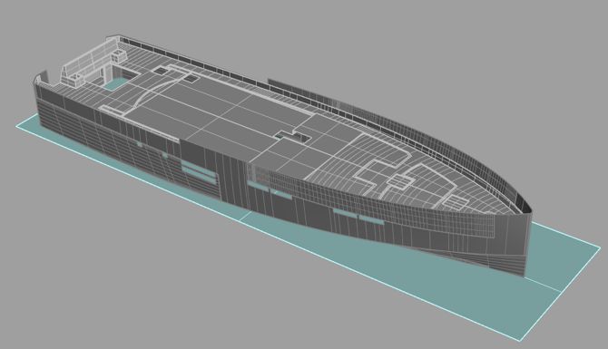

    It is sure most of well known or older designers use 2D design or free hand even today, to start the sketches, but a digital Tablet today helps, most are digital today. In most industries I had contact, I used to handle with 3D CAD Catia V5 to do the projects, but the designers I've meet in Kaiserwerft and Hanse Yachts used to use Rhinocerus 3D for their designs as well, mainly making the hulls and superstructures, because the licenses are cheaper. My projects at Hanse Yachts, the H385 & H575, we have done all the Product Design Engineering Department, using tools like PLM Smartteam and 3D Cad Catia from Dassault Systems, but also Autodesk Autocad for the plannings and Deck Layouts. They use also DMU softwares in 3D for Rapid Visualization. I've known other italian yacht designers who did some works with Rhino as well. It is quite common the naval architects to use Tribon as CAD Tool in Ship industry. Meyer Werft is common to use also 3D Catia V4 and i had some contacts in Hamburg where most of Offshore wind Shipbuilding Companies construct their things using projects made with CAD Catia as well. Other 3D softwares are also known, but Photoshop and 2D illustrator is spread use as well in merchandising of Products to do realistic Renderings in base a 3D Data. This is what Judel/Vrolijk Design company do to the Hanse 3D Projects for the Sailing Boats Photo-realistic things. Maybe also many Graphic Design Softwares spread in web. So at End Yacht industries and Auto industries are both using VPM strucures as well for managing the thousand parts in the Data Bank. Actually there is no difference anymore in methods, if is an aircraft, auto or yacht industry. I managed all them in 3D CAD Catia V5 Laptop !

  9. yes, you can undestand so. Most of parts are done so in all types of vehicles industries. For example the stearman seat was made from nothing in a simple design in rhinocerus 3d, then I took it, converted in Catia and from an empty model I did all again in a shape model for tooling in GFC in another 3D CAD, doing the whole design again, but in precise way, seeing for example draft of tooling and cosiderations for production. The rhino design from the girl, my ex-colleague, was not precise, just used as reference how the design more or less should be. But then most details were different decided, you can see the pictures spread in web. The results were in just 2 days of working stauning good. Then is ultra virtual realistic used in presentations as well. Actually, as designer, I prefer doing from nothing to have to reuse and redo the errors from others. Well 2 yachts is current in construction and are to be launch in August. So it's a fast procedure. The Rhinocerus Surfaces were in tolerance unprecise. I re-did all from nothing. This is because Rhino is freely than a CAD software, even when you have in Catia V6 industrial Design integrated as well, better also than Alias or ICEM Surf for shaping. Me as designer and engineer prefer to do all the same time regaring the engineering and shape form directions. It is much easier. I understand because the girl is fresh from university and is just few designers who are designer and engineer understanding both sides equally. Unfortunatly the big industry is devided in that, but a small yacht company can not reserve the right to pay high for that. It would be unaffordable in the cost of the more or less low price of some thousand kilo euros for a small sailing boat to make money.

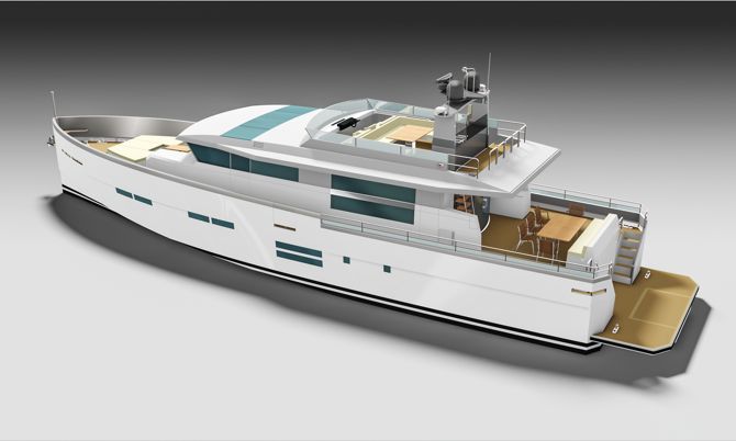

  15. Thanks Atomare for the wonderful answers. It's like we professionally also do. To say trully i do all my work today direct in Computer. The Materials like Markers and rules are deposit in basement. We know that old generations still use pencils and paper as main tool, because they do not have abbility at all like the new digital generations' mind have. A question about culture 'grow-up with' to be common with those tools. Of course my career started with tools Markers like Copic or Pantone in a piece of paper, but if today we have in market a digital Tablet like Wacom & a gratis Alias Sketch Pro does cost almost nothing to do more with much more ressources, so we go in this direction. Of course tools, like pencils, 2D programs, copy machines, napkins are still common in all design offices. This is still an old complement, but also in factories CNC, 5 Axis drilling Machines do the pieces of motors, frames, wood etc, or you still do with water drilling mills to make a hole ? A digital computer with all dreams inside cost no more than €2000 and easier to carry, so I go this way. Others who still prefer to carry a baggage of heavy wonderful colored pencils in the arms can still go in the not most advance technics. Both have very good results. But 3D Model is very easy to change, and can go directly to the CNC machine. The piece of paper colored can not.
    If you still work so, go ahead, of course I believe there is a space for your boat in market, because the planet is huge and we have > 5 billion people in Earth wanting a private boat. ;)
    [​IMG] Source
