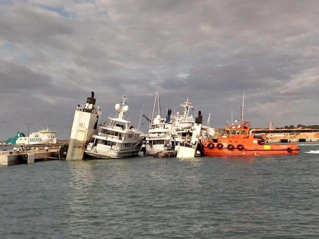

    The SuperServant delivery ship has toppled over in Palma de Mallorca.
    More news as it comes out.

    Another angle. A captain on another forum said it was an electrical failure with the ballast pumps.

  5. Pascal
    8,722
    Has to be a ballast issue but surprised they don’t have shut off valves in case one the pumps has an issue.

  8. DOCKMASTER
    DOCKMASTER Senior Member
    Feb 26, 2012
    1,555
    Ketchikan, Alaska
    The valves have manual override. But depends on when it happens and how quick the crew is to get there. The stability of a ship like this when it is ballasting down is just like a drydock. Stability is directly related to the width of the waterplane. Once the deck goes underwater the GM drops significantly as the width of the waterplane is greatly reduced. If the ballast is not correct for the load and the ship lists, you get what is called the multiplication effect of all the liquid loads shifting to one side. The most critical phase of stability is when the deck goes awash but the loads are all still 100% on the ship due to blocking heights of the yachts.

  11. Capt J
    14,641
    Supposedly, they lost power when sinking the ship and couldn't get to or reach the manual valves to close them, causing the one side to fill with ballast water and now the entire cargo has shifted. They have tugs pushing it and are afraid it will roll over without the tugs.
  12. DOCKMASTER
    Feb 26, 2012
    1,555
    Ketchikan, Alaska
    Hard to imagine tugs have enough force to keep it upright if it really wants to go all the way over. But I guess if it is just at zero GM or a little negative it is theoretically possible.

  14. Capt J
    14,641
    Quite a bit, the yachts are all leaning on top of each other. It's too early to know and the ship isn't stabilized yet as far as anyone knows. It's quite possible that it could roll over, yachts and all.
  15. rtrafford
    rtrafford Senior Member
    Jul 13, 2019
    1,824
    Vero Beach
    I mean, call me crazy, but start adding water to the high side, even if by hose from the surface?
  16. d_meister
    d_meister Senior Member
    Mar 4, 2010
    487
    La Conner, WA.
    It could be ugly. At that stage of operations, all of the sea lashings have been removed, and the hull stands are still welded to the deck. Yachts shifting and floating around could hit sharp corners or edges of the stands, not to mention the boat to boat topside contact.
  17. DOCKMASTER
    Feb 26, 2012
    1,555
    Ketchikan, Alaska
    Unfortunately, not that simple. First of all, just getting to the tanks can be an issue. The tank lids are likely underwater or not safely accessed. Recovering this vessel safely requires a highly experienced salvage team which will include many stability scenarios and modeling by qualified Naval Architects. Otherwise you run the risk of completeley sinking the ship and having a much larger disaster.
