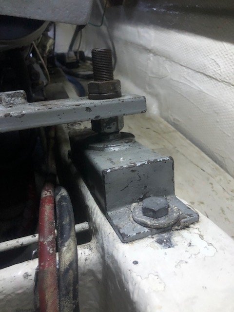

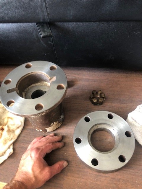

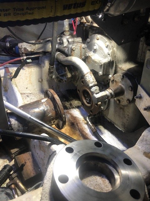

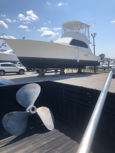

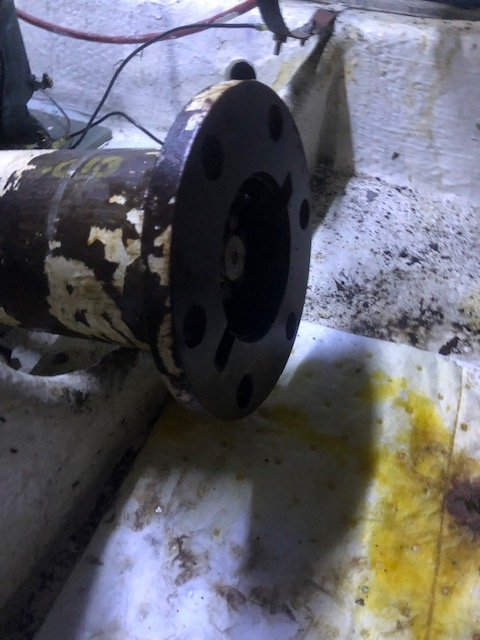

    Guys sorry for the delayed reply, things have been busy. I hauled the boat and pulled the shaft. Everything went to the machine shop. The shaft is perfectly straight. The coupler has a 2" thick iron spacer ahead of it these were both faced true on the lathe. A new key was made for the coupler bore. We put it all back together. The wobble remains the same. Performed an engine alignment.... The mounts are bedded in an epoxy atop the stringers so unable to be adjusted side-to-side. We were only able to tweak the heights of the 4 corners. Not perfect. The coupler seems to spin true, the wobble is at the shaft. The theory now is that the coupler bore is off-spec, or maybe the key is not seating all the way. I will tear into it agin when she comes out in the fall

    What's up with the spacer? Shaft not long enough?
    I do hate spacers.
    How are you sure the spacer is centered perfectly on the clutch output flange?
    Looks like a big sloppy recess for the clutch flange to center into the spacer.
    How sure are you the shaft coupler is fitting the spacer perfectly?
    I do not see a picture including the male lip on the spacer to center the shaft coupler.
    I'm guessing, the clutch flange did not go to the machine shop or did it?
    Clutch flanges are easily damaged during clutch R&R from / to the boat.
    Amazing nobody ever checks them after the smallest strike.
    Or, the flanges are bent using it as a press back when trying to pop out the shaft from the coupler.
    Sorry I did not think about this during your thread.

    The coupler and the spacer have a centering lip and recessed edge so it all goes together with no play. The clutch flange was not removed. The machine shop asked if the boat had been repowered due to the spacer. I know the 692's and gears were replaced with 692's and gears, but I don't know if the gears are the same model. These are Twin Disc 509's
    The coupler and spacer seem to spin true, the shaft is where the wobbling begins
