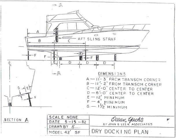

    Storing with a new yard this year. Does anyone have the recommended blocking procedure for an 1988 Ocean 55?

    I have attached the blocking instructions that I got from ocean a few years ago when I had the same question for my 1989 38 ft. This drawing is for a 42, but I see the instructions go for a range of larger sizes.
    hope this info is helpful

    Hey Trinimax , Thanks for the Drawing! That's hard to come by. I have an 81' 42' sunliner. I just printed it out and will put it on my boat.

    That drawing may not be applicable to your boat? Dunno
