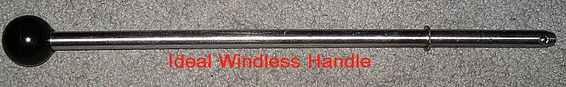

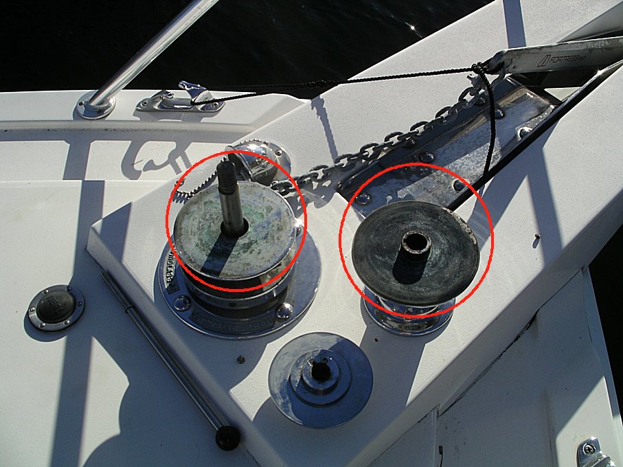

    Schaefer sold me the "handle." Got it somewhat apart this afternoon and was able to remove the broken section of the little screw. Not sure if I got enough apart to get to the clutch but do the two parts that were together circled in red need to be polished up ? Surprising to me neither part was frozen and once I removed the chain, lifted right off.

    Now, The chain sprocket should separate from the bottom face and come up & off.
  16. SplashFl
    SplashFl Senior Member
    Feb 2, 2021
    729
    S. Florida _ Bertram 46
    Yes, got it all off and after some cleaning up, light grease on bottom of chain wildcat ordered new wildcat to accommodate new larger stainless 3/8 G-4 chain, also ordered, as the old was 5/16's with unknown strength rating & the charts showed on the edge for vessel size and in this case, I believe more is better. Been yet another learning experience.
