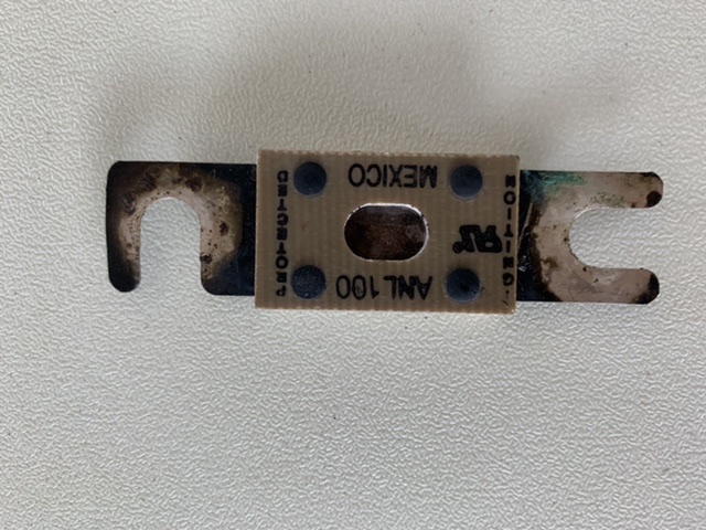

    I have looked in the rope locker, the electric panel and turned on every spare. Searched in every nook and cranny in this boat but i can not find it. I did text the previous owner in hopes he will answer and shed some light. I will keep you posted.

    Try to avoid that wire trace....don't blame you. Do you have a sub panel inside your bridge console? Stay safe.
  4. Capt J
    14,903
    I've seen them on the main panel in the salon on other Ocean Yachts. It really can't be that hard to find to trace the windlass wires on a 53' Ocean.

    The problem with the tracing is the wires are running behind some closets the previous owner remodeled, but did not leave access to the back side so I can follow them all the way through. I did get a text back from the previous owner that told me where he "thinks" it is. I am beginning to think maybe there wasn't a fuse at all and they went straight to a battery or bus if that is possible?

    Agree with Capt Ralph, Ocean is not going to leave that line without a breaker. So lets assume the breaker is not located in the hard to get to locations. Try to follow the wires into those spaces and then out. We are assuming your windlass is inoperable that's why you are in search of the breaker. If its operating and you can't find the breaker thru a trace, you may want to splice one in close to the battery source. Worst case is that you have 2 breakers.

    This, the OP needs to find the factory breaker. Which might not be a breaker at all, it could be one of the flat large glass fuses. Hatteras liked to use those back then as well as some other builders. I think Ocean did as well for some items. I think Ocean used DC windlasses and every Hatteras that I know of also used DC windlasses.

    Anything is certainly possible, but the previous owner did some modifications that sometimes do not make any sense. I have an original Ocean schematic in the owners manual showing were it is suppose to be, but it is not there. Thanks for everyone's input and when I get to the boat this weekend I am going to see if I can trace the wires from the windlass. It is in fact not working and had been a few weeks ago. This forum is a wealth of knowledge!

    Finally tracked it down in center hatch between battery banks. Not what I was looking for.

    Ocean did this ? or the previous owner? Not great. Run the wires to a serviceable easy to get breaker, ya think?

    I believe it was done by previous owner. It was no where near where the wiring diagram for the boat had it.

    I had a few of these type fuses behind the panel where all my battery selector switches are and was from the factory. It really burned my azz that they would put fuses where you couldn't even get to them without removing the whole panel (PITA). So we did exactly what cleanslate said. Got rid of the fuses and wired in breakers instead and put them in a logical, accessible location.

    But you got it.
    Does your windlass work now?
    Yep, Re-run the wires with some nice heavy cables and locate the breaker in a good safe place.
    Remember; The breaker should always be off when not in use.
    Mounted somewhere easy to reach.
    Mounted somewhere that after short / brief instructions, a guest can easily find it to turn it on / off.
