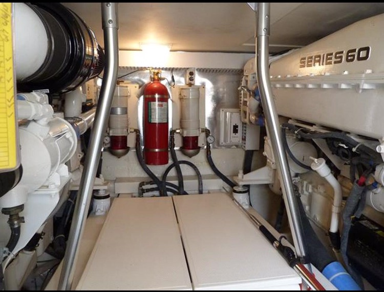

    You can see the one in my boat just to the right of the fuel filter.

    It is a 53 ocean ss 1992. Thanks for the pic Alvareza that helps.

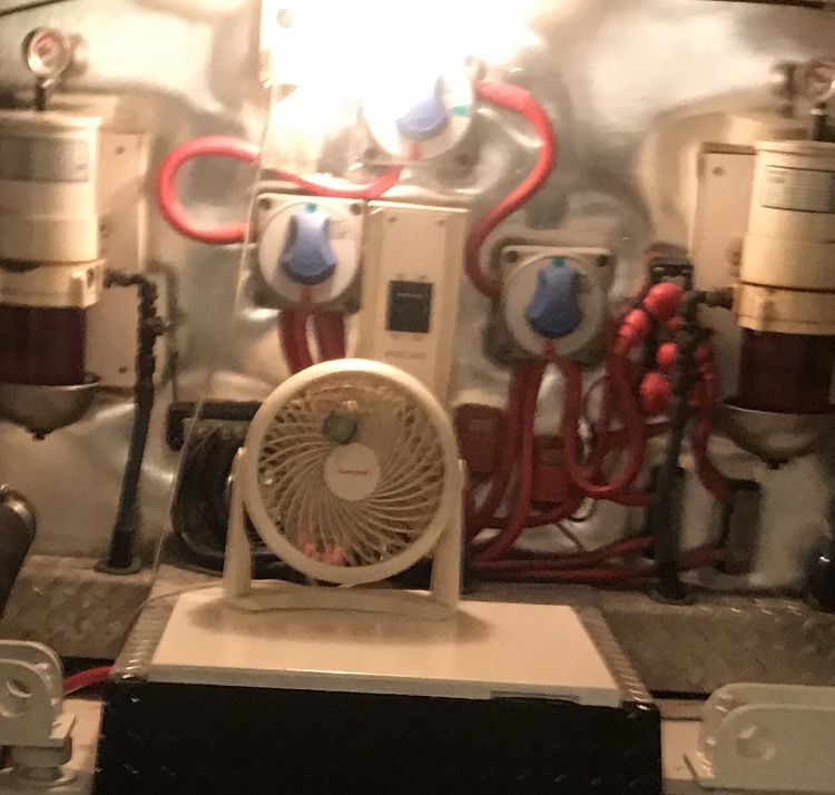

    behind fan between battery switches

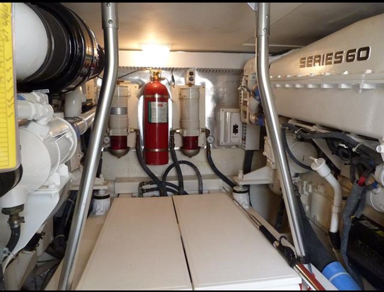

    If you look carefully there is still work to do...
