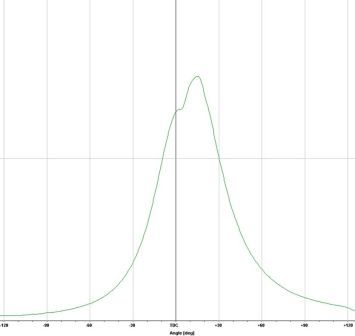

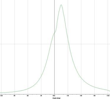

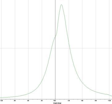

    4. About "injection timing" and "bad atomization". Please have a look at diagrams below. All 3 are taken from one cylinder. This is my explanation.
    P.S. Exhaust temperaures can not be used as reference for cylinder balancing solely. They are only relative indication of process.
    Well, it's possible to have them all equally adjusted, however, this will not mean that all peak pressures (Pz) are equal.
    This is the pressure force, what makes pistons moving, not temperatures.
    rgds,
    Andrei
