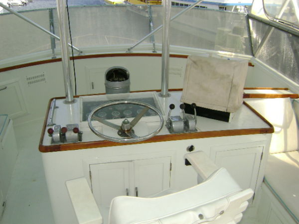

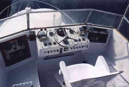

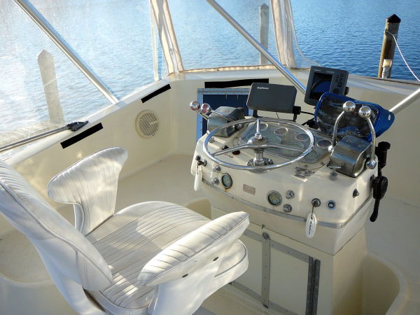

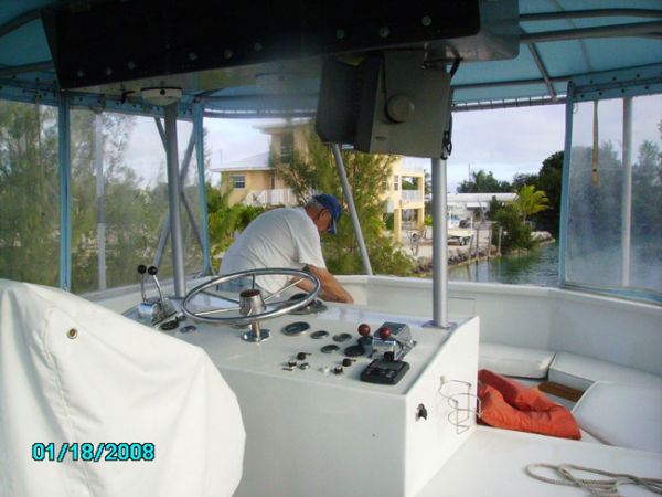

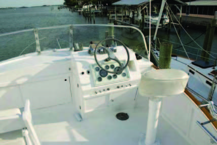

    For an idea, here are some examples of what sportfish/convertible bridge helms looked like "way back when" from YachtWorld broker photos - a 1970 Hatteras, a 1967 Hatteras, a 1957 Whiticar, a 1974 Norseman, and a 1959 Norseman...

    NYCAP, i thought you were kidding, i was just making sure. im always up for a good discussion, thus the reason for signing up. but im not here to insult people, and i was just making sure i didnt insult you.
    its always good to bounce ideas off eachother, but its also good to bounce disagreements... so u get all sides of the story.
    Seafarer, i like the pics u posted. its amazing how much cleaner the centre console has become over the years. the 74 Norseman would be interesting to operate under pressure.

    anyways, with the boat second from the bottom, what is the third controller for on each of the sides... my guess is, forward - reverse - speed...?
    far
  18. NYCAP123
    11,209
    OK, this is starting to sound like a conversation I have with my wife about once every...anyway, you made a joke and I responded with a joke. and I'll put in the :D my friend.
    As for the 3rd stick, good looking out. Unless he's running trips I don't have a clue.
