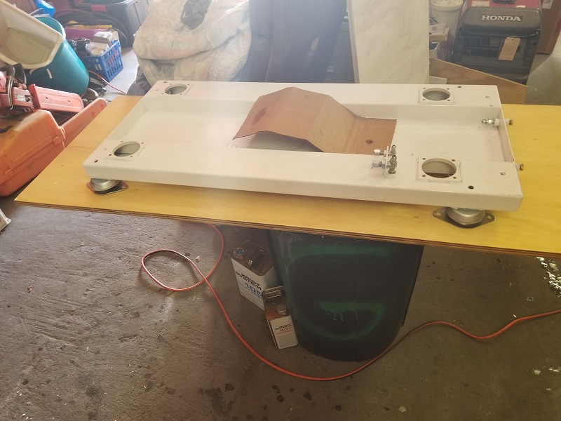

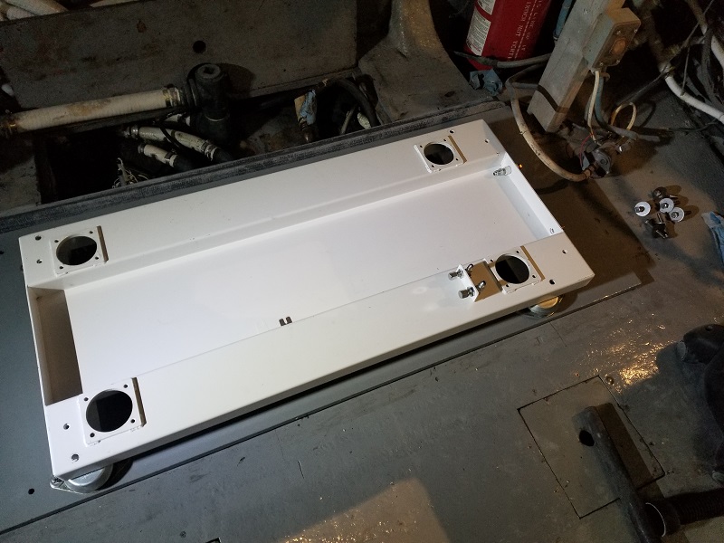

    The way to quiet and limit the vibrations of your genset is to double resilient mount them.
    That means the generator engine and alternator is mounted to the base frame with resilient rubber mounts. Then the entire unit is mounted to your boats foundation in whatever space it is located with another set of resilient rubber mounts between the base frame and the foundation it rests upon. There is some further work to pay attention to the center of gravity as that is where the mass of the unit works through (physics) so the smarter applications usual have at least 6 mounts, one at each corner and 2 aligned with the center of gravity. It will then be ultra smooth and barely noticeable during operation.
    And if you want to get fancier, mount your lift muffler base with a set of rubber resilient mounts to the boats foundation to round out the quiet system.

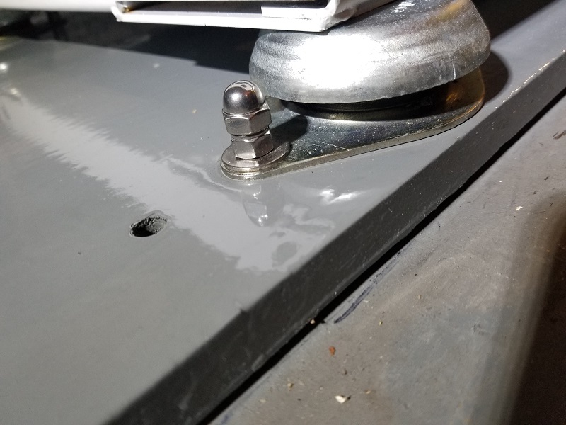

    The original Hatteras gen-set room decks were solid but had drooped down a little in this project. I epoxy sealed a new 3/4" ply pad to bolt down. Then the NL external mounts with the gen-set tray on top of those. I was worried the modified deck would act like a drum. 2 cartridges of 4200 were applied between the deck and new pad to fill the voids. A few days later I started tightening down the carriage bolts between the original deck and new pad.
    Ahh, Perfect.
    There is no drum effect under the gen-sets.

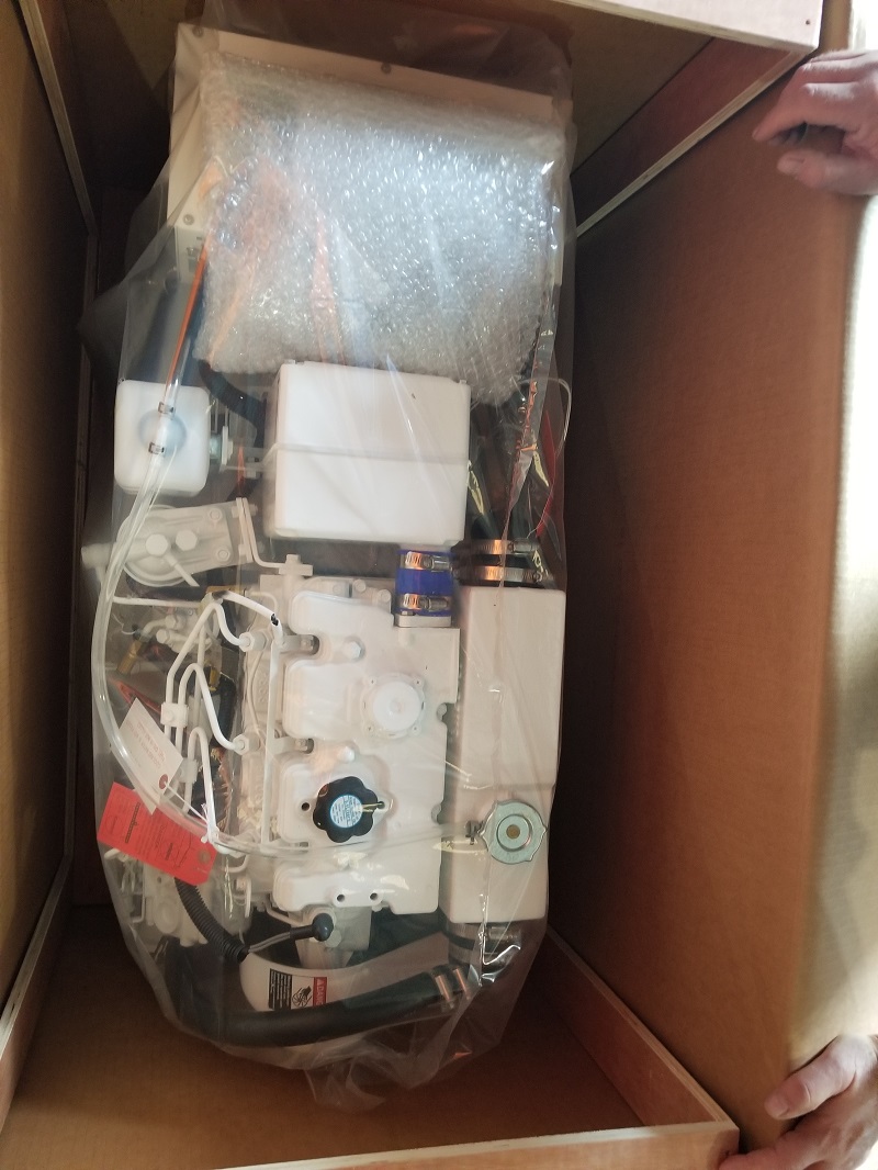

    NL all the way. Just installed a new one with the Gem enclosure. Have it on the isolation pads. Quiet and no vibration. 500 hours in 2 months.

    I just installed two NL gens; a 9kw and 20kw, both with their Gem series enclosures and doubling the isolation mounts. This went in place of an Onan (20k) and a Kohler (8k). The NL units are fantastic so far. Much quieter and less vibration. And their customer service through procurement and installation has been great! I couldn't be happier!
