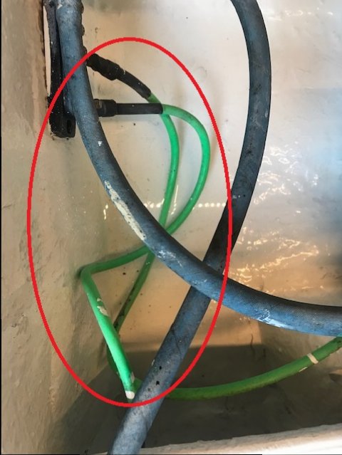

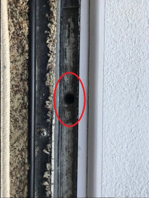

    I noticed a slight drip from a hose behind the Starboard motor. Turns out there is a drain hole in the salon door track that drains into the engine room behind my starboard motor. I put a cup under the hose in the Engine room and poured water in the hole in the salon door track and it ran into the cup. Water must hit the door while running, raining or washing the boat and drain in the engine room. See pics attached. IMG_3564.jpg IMG_3566.jpg Screenshot_1.jpg

    Nice, good find to the possible OP cause. Another great Ocean short cut is to run the condensation lines from the A.C. units into the bilge. At least that is what was done on mine, 1981 42'. I added small thru-hulls for all the air condensers to drain over board.
