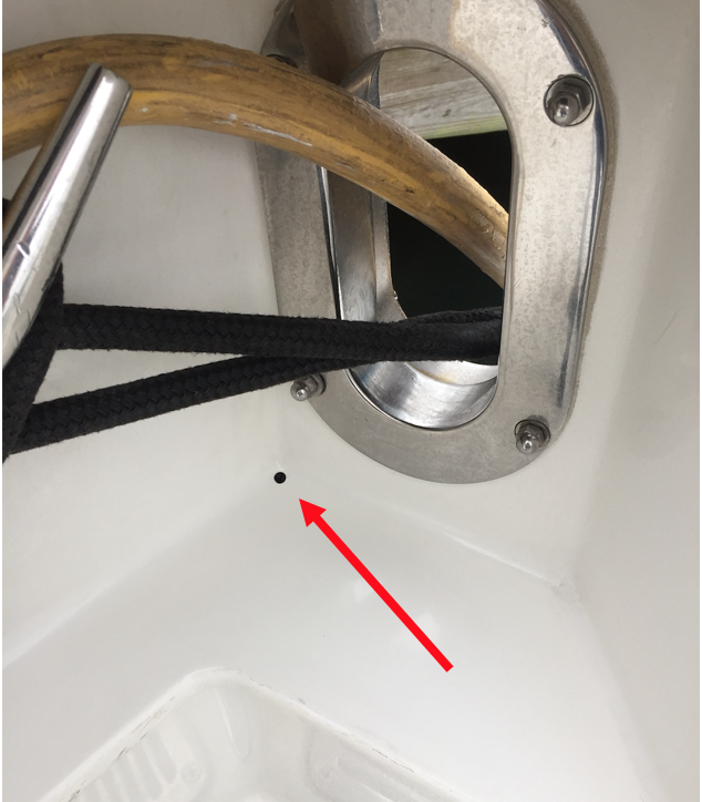

    Mystery finally solved. It's a combination of (mostly) fresh and salt water entering the bilge through the small drain holes in the aft corners of the cockpit hawse pipe pockets. Instead of plumbing into the cockpit drain system the factory (inexplicably) decided to let water weap directly into the bilge. - at least on my build. Rainwater and wash water accumulate in these recessed pockets - along with a little station wagon effect salt water - and drains into the after most bilge corners. The water runs forward in the longitudinal channel under the raw water exhaust, through the aft ER bulkhead and spills into the space below the gears as the boat pitches. Often wondered why I saw more water after a long run in a following sea. The 43 owners here will understand that comment.

    Tashmoo
    Any pictures? Try to figure out what the small drain holes in the aft corners of the cockpit are?

    I am not totally sure water drains from the engine bilge forward to the master stateroom bilge. In fact I think there's a solid bulkhead at the engine room to prevent water moving forward. I am guessing this as I can't see behind the battery compartment but my forward bilge can be dry while I still have significant standing water in my engine room so that's my guess. With respect to how water gets into the engine room bilge, there are a LOT of ways. Could be engine room doors, rod holders in cockpit coming, the drains in the fish boxes, and those little scupper holes in the aft quarter you mention ALL drain into the bilge and wind up in the engine room. Nothing on my boat is plumbed to go overboard. So when it rains I accumulate significant rain water in the engine room bilge. The worst is those stupid fish boxes. No matter how good your hatch gasket is, the gutter has a hole drilled into it and drains into the fish box. So that fishbox fills up with lots of water. On the smaller one, it drains straight into the bilge.

    Interesting, my 43 does not have those drain holes, and water pools there. The smaller aft cockpit hatch drains into a sump with a separate pump, ( I believe the previous owner did this,) but as you say after some heavy rain the fishbox fills with water, which is rather annoying. The engine room does get some water in it if you are not careful when washing the deck by the cockpit entrance. I might look into installing a heavier gasket there. Other than that the boat is pretty good with a few head scratchers as you say, but then again, all boat builders do things that will make you wonder.
