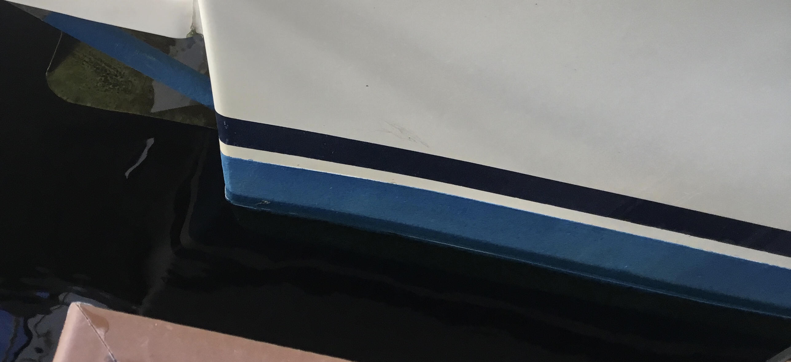

    Hauled out this summer and told the yard I wanted Trinidad Pro, just like last time, 27 months ago. (The old Pro was getting a bit thin, had a diver every 60 days or so, even when using the boat weekly come hell or high water, but the diver is not gentle on the paint, probably had him clean the bottom 11 times during the 27 months, it was time for a bottom job.)
    This time, July 2020, the yard said Oh No, a much better Petit paint than the Trinidad Pro is out now, called Trinidad HD, not only is it better, but also cheaper.:eek:
    Went back home and called the paint manufacturer, talked to customer service, they confirmed the new Trinidad HD is better, and cheaper..
    Ok, sold. The yard did a good job prepping and rolled on 2 coats, also Prop Speed on all metals to include rudder, tabs, prop and skeg.
    Barnacles are indeed absent after 4 months, a should be, but slime builds up much faster than with the Trinidad Pro, so much for better paint and less money.;)
    I should call somebody and b!tch, but too laid back.
    Will insist on Trinidad Pro next time.
    In the meantime, with the King tides we are having, easy enough to use a long shaft boat brush and clean the water line slime off, every 2 weeks now.
    Got bright blue paint, easy to see slime, with black paint it is invisible and not a problem.:confused:
