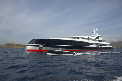

    In the large yacht sector, does Feadship have the answer?
  4. K1W1
    7,453
    I wouldn't say so with that particular boat anyway.
    She has 4 x MTU's driving 2 x CPP's through RENK Combiner boxes.
  5. NYCAP123
    11,209
    1st time I've seen her launch with the matching bow. Wonder how that's working out with a small boat. Seems it might be wet.

    I don't think the guy who put 4 MTU's together to drive 2 screws was too concerned about what most people define as efficiency. ;)

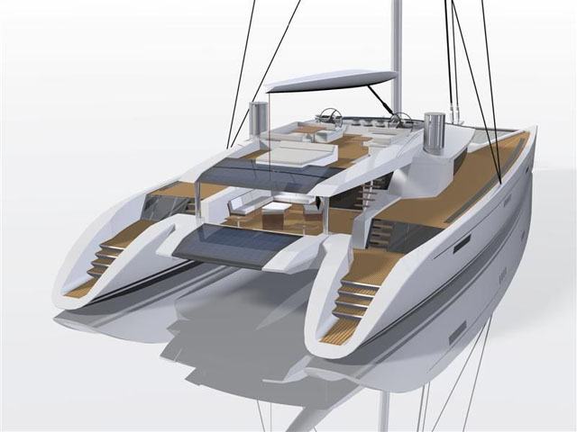

    Some interesting details for a new 30.5m superyacht design called Code [e];
    The vessel will have a hybrid (silent) propulsion system which does not emit toxic gases, has an independent running time of 15 minutes and can be used to moor in port or to access an anchorage. For long distances, conventional fuels are still required. The yacht will be equipped with 40 m² of solar panels, integrated into the structure of the vessel and able to provide 35 kWh in clear weather. Other features include two vertical and retractable 1,110 W wind generators, positioned on either side of the coach roof. Two hydro generators provide electricity when under sail, and the use of LED lighting throughout. Lithium-ion batteries have been chose for the design, as they provide the best energy-to-weight ratio and, when not in use, the slowest discharge currently available on the market. The wastewater treatment system treats black water and grey water without any discharge. An electric load shedding system enables electricity load shedding to be monitored automatically, reducing needless peaks in consumption and the need to resort too frequently to the electrical generator.

    More catamaran Superyachts will be built. :rolleyes:

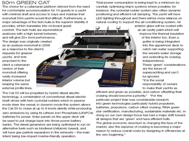

  18. Dan Evans
    Dan Evans Senior Member
    Jun 17, 2007
    123
    Port Townsend
    I dont think there is any more R&D to be done on diesel electric systems, sure future systems will be more efficient but whenever you convert energy from one form to another you will lose some. I cant see diesel electric becoming popular because of the added weight and loss in efficiency. Its possible for this energy to be gained by solar/wind/tide generation but then there is the problem of the weight of all that energy and the lifespan of the batteries it would require.
    Dan
    By the way, where can I find more info on this 50m powercat?
    thanks
  19. battboy
    battboy New Member
    Feb 24, 2009
    7
    Nevada
    First of all what is you concern with weight refer to? Current Lithium battery technology is 1/4 the weight of any SLA system and far superior to any performance. Regarding more info I suggest you contact the designer. His website is: http://www.sabdes.com/
    Hope this helps you.
