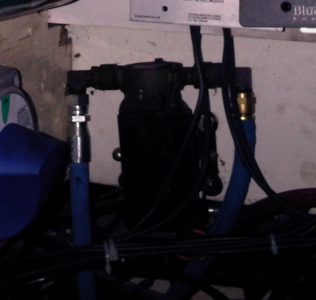

  1. P46-Curaçao
    P46-Curaçao Senior Member
    Mar 8, 2013
    734
    Bad picture, but it looks like this: ssss.jpg

    I am not on Mayhem now, but I don't recall anything like that. I will be back in Virginia tomorrow and will search for it but I know it is not there, I have already done a drawing of the entire fuel system for my book (ex navy, have to have systems drawings, forces of habit!)

    No fuel priming pump on my 43 either. STB motor is going to the rear tank which makes it a long fuel pickup run. Maybe you can remove the hose under the cockpit floor and get it partially out the hatch to try and fill it some? Or get suction on the outlet of the Dahl to pull it? Gen hose is smaller and may be an easier fitting to work with since both come off that primary filter.

    Thanks everyone. My son called and said he bit the bullet (fitting) and siphoned the fuel back up to the Dahl. In the morning I will finish with the filters and head.
