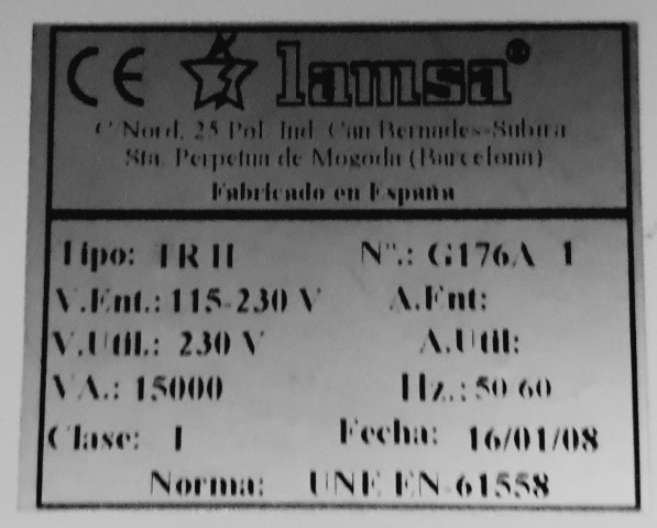

    Unknown "box" in engine room: What is a Lamsa 15kVA box for the main shorepower?
    No documentation on board....

    I'm not an expert, but it looks like a transformer to me.

    I believe this allows you to input 115 to 230v (50 or 60Hz) and puts out a clean 230v for you.

    Yeah, probably some sort of isolation transformer.
    Hard to tell without seeing how it's wired into the system

    Based on the label it looks like you can input 115v and get 230v out. I’m a little confused by the ENT 115-230though. This would imply you can input anywhere from 115 to 230 and then get 230 out. I’m not familiar with this much variability in allowable input so I may not be understanding the label correctly.
  8. Pascal
    8,716
    Euro 230v is one hot at 230... it’s not like the US 240 where you have two 120v hots on opposing phase.
    a transformer can take 115v and output 230v.

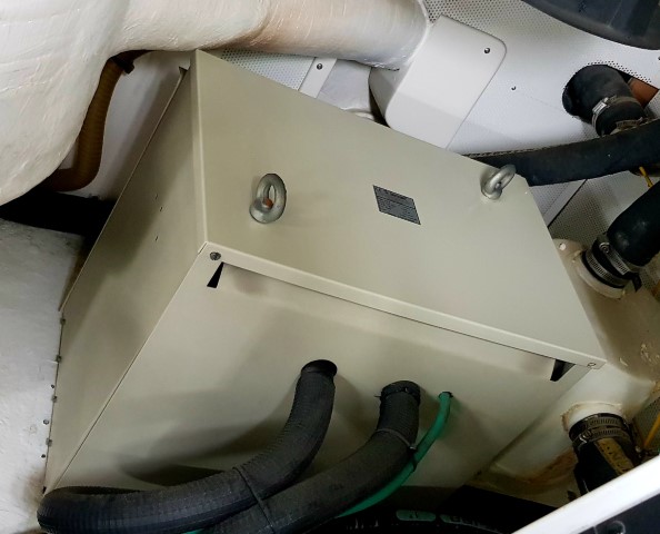

    If it isn't, its plate certainly reminds of one.
    I'm a bit intrigued by the two large-ish black hoses that look like meant for water, though.
    Are there electrical cables inside them possibly, and they are used only as additional protection?
    I never came across a liquid cooled isolation transformer.

    Off topic, but a few years ago ASEA was developing liquid cooled shore power converters to eliminate the high heat out put, and also allow the units to be installed in a high ambient area.
    Another well known mega yacht builder I worked with had to install large A/C air handlers in their shore power converter install area, which lead to a significant increase in A/C chiller size.
    Gotta dissipate all that heat somewhere.

    In my opinion, it is an ASEA unit relabelled by the Spanish importer. But I am not on board at the moment to check.
