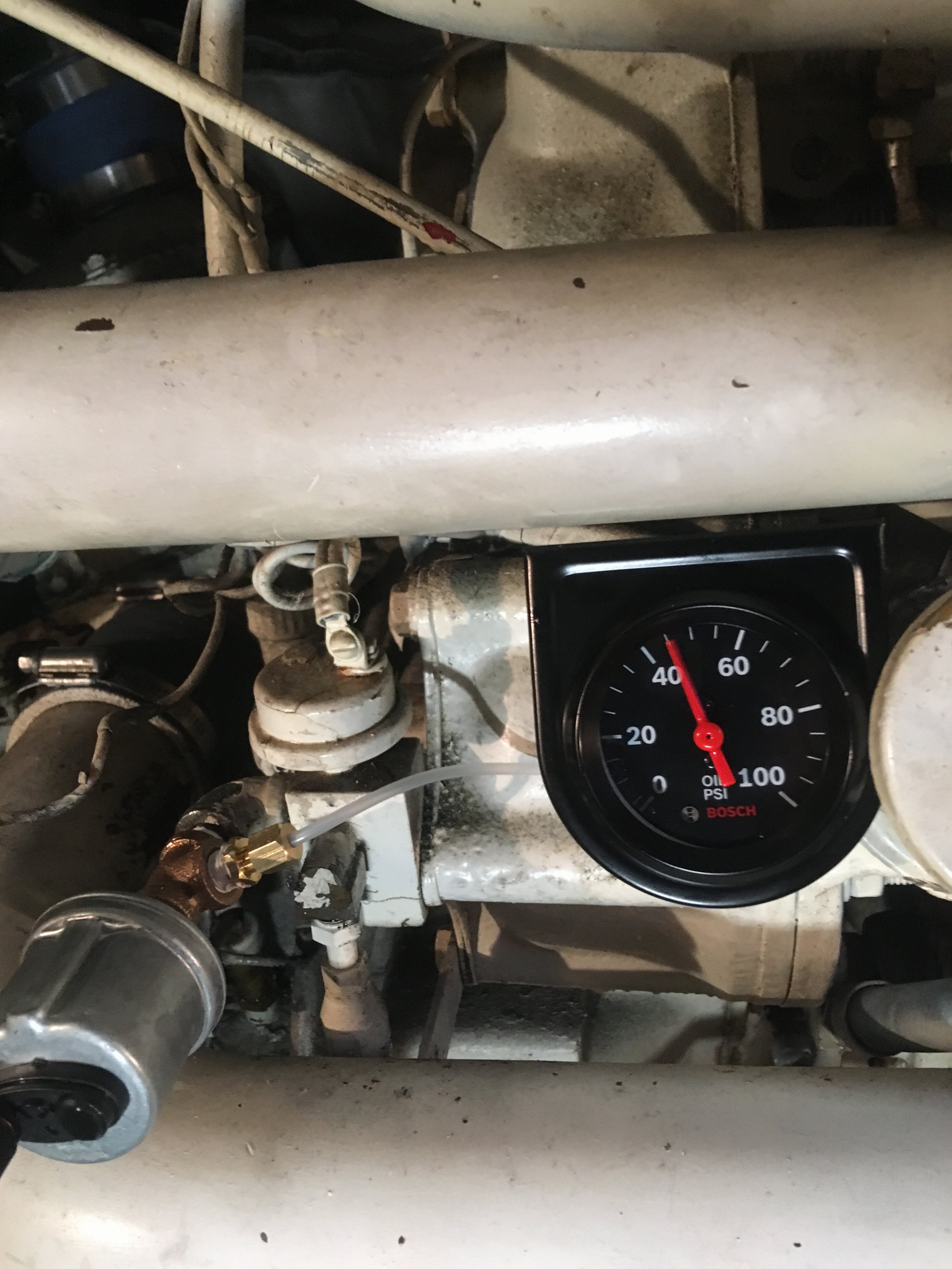

    I just installed two mechanical oil pressure gauge is at the engine .
    Got them both along with the fittings for $20 each at the automotive store .
    I did have to purchase two 1/8” tees and two close 1/8” nipples, $15.
    I ran a hose clamp behind the mounting bracket on the gauge and clamped both gauges to the oil filler tube on the engines . Done deal ! Yay works great. $55, and 1 hr time to install.
