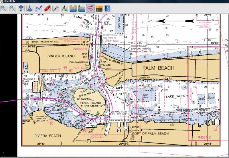

    Learn new routes everyday...:) .. well not everyday, but this is good to know. Is this route marked? It's faintly seen on the google earth pic.
  10. Pascal
    8,948
    interesting... the water on the east of teh ICW look pretty skinny, with some 7' sounding... the ICW while not very wide is pretty deep south of Peanut (at least 10' MLW). it's around the back side of Peanut that you find some 9' sounding in the channel

  11. C4ENG
    C4ENG Senior Member
    May 19, 2006
    581
    Ft Lauderdale
    From the charts, I would not think to take that east of ICW route in a 9 or 10 ft draft vessel.

  12. Chevelle
    Chevelle New Member
    Jun 27, 2006
    42
    West Palm Beach
    1-Charts lie.
    2-My Bad. Scuttlebutt last week was that they had smoked an engine. Have know heard that it was oil cooler problems. "Cattech" knows what happened, but he is not saying, for obvious reasons. They were towed out of the marina and set free in the "Lake" yesterday.
    3-The east channel is plenty deep, but Captains get freaked out driving the big iron through there. I have stood next to more than one Captain coaching them to the yard from the port, and I'm just an engineer (chuckle)
