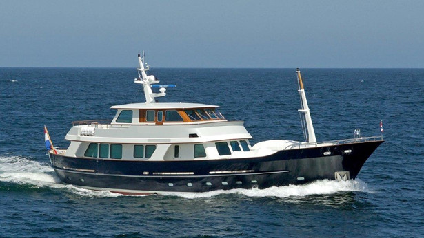

    This B & B 74' yacht is a mix of many of the things you would look for in an Expedition small yacht, but all done differently. With a range of 5500 miles, a strong simple engine (Kelvin, an institution in commercial fishing) and the large tenders up forward.
    On the other hand, she is all aluminum in construction, has forward facing galley windows and is very elegant.
    She's also my Lotto boat.
    Yachts for sale
    index.Kelvin
  10. YachtForums
    20,943
    You've got good taste Dave. That's Griffeon, built by Nico's crew at Bloemsma Van Breemen. I was onboard the boat a few years ago when I toured their yard in the Netherlands and subsequently wrote the review on Valquest. At the time, the owner's health wasn't good and Griffeon was up for sale. Wish I had the funds...

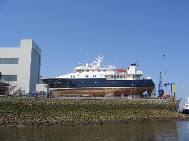

    I would like to show you one of my favorite explorer / expedition / retirement
    yachts. I took that picture on the weser river at the Fassmer yard.
    This boat is a single engine (medium speed MAK engine), variable pitch prop
    version with emergency propulsion via PTO / PTI and shaft gen / motor,
    unfaired hull, ice classed, long range, 4 double cabins plus owner and crew.
    The boat is full SOLAS commerial classed. It fulfills all "green" requirements
    for going into sensitive areas, like arctic waters, has dry exhaust stacks and
    is equipped for worldwide cruising, both in very cold and tropic enviroments.
    Things I would change are:
    Make her a bit larger (180 to 200 feet). Main engine power about just under
    3000 KW, not by means of a heavy MAK engine (to much height), but with
    two MTU 16V 4000 M53R Ironman geared through a Reintje 2 in one, 2-speed
    gear on a single shaft with VP Prop, but still with shaft gen plus 2 diesel Gen.
    By this setup the boat could cruise single engine without creating asymetrical
    thrust. The boat should be DP-2 capable by means of a Schottel pumpjet or
    retractable and steerable thruster. Besides the strakes I would add 2 B&V
    retractable, zero speed stabilizers. No bulbous bow, I would go from ice
    classed to ice going, therefore icebreaker type bow, like on the picture. The
    extended length would be used to create a landing spot for a light helicopter
    (Robinson R-66, whenever he gets EASA certified) or to accomodate a single
    engine (Soloy-turbine) float plane. If the landing spot could not be certified
    under LY3 or IMO/SOLAS regs, the heli could land on floats and be
    hoisted on to the deck. Flexible setup for tender and toys, according to the
    planned route.
    Cheers

    Why would you want an ice breaker bow? All the sea keeping abilities of a goldfish bowl. Unless you are going to be actively icebreaking or spend all your time in some very sheltered harbors you don't want an icebreaker bow. There are even icebreakers who put their icebreaker bow on the stern and break ice backwards just so they can have a real bow on the front when they are en route through open ocean.

    You are correct. I do mean a mild version of an ice breaking capable bow, like
    shown on that picture. I am familiar with the seakeeping disadvantages of a full
    icebreaking hull, as far as comfortable cruising is concerned. The big guys
    compensate that with their heavy mass. I am just dreaming of the nordwest
    passage or going around Jan Mayen or Greenland. A bulbous bow would be
    counterproductive for that purpose.
