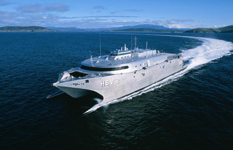

    HSV-1 ride
    I spent about 36 hours on HSV-1, and INCAT design of about 300', in a range of conditions. I generally don't feel queasy at sea, but did on this vessel in moderate seas... it was like a being on an airplane in turbulence and a boat in swells at the same time.... strange lateral motions.
    That said, coming into Morehead City there were 15-20 foot breakers at the entrance and as we entered I was on the bridge monitoring a 17" monitor that had been placed on a Nav table for the short day-and-a-half test ride. A wave brought us maybe 15 degrees off level, but dumped everything off the table, including the monitor.
    The point is... I actually felt quite comfortable during that part of the ride, but it was the lateral shifts that caused the spill, which is a significant aspect of cat designs that I don't think most recognize.
    The pic of HSV-2, a sistership I had a handy photo of...

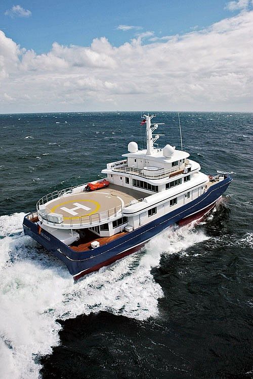

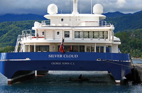

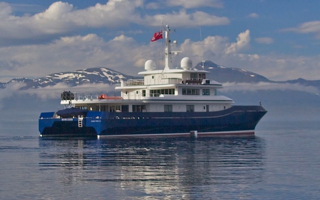

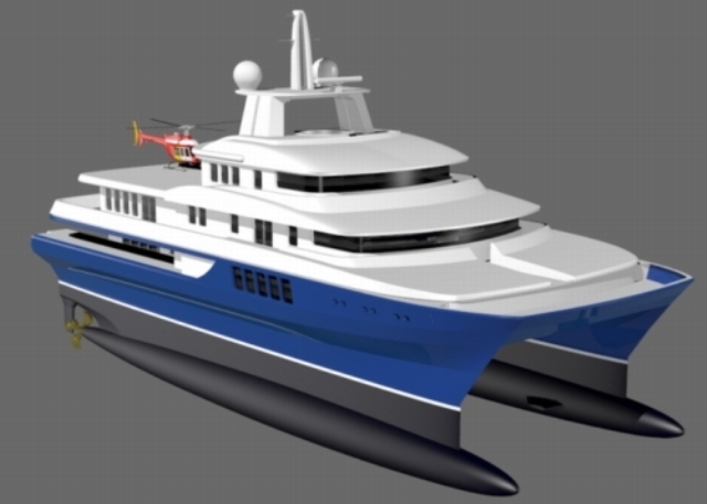

    The pictures above show Silver Cloud before its return to A&R and the modification of her aft deck. The hangar for the tender was removed and exchanged by a lowering platform, were a smaller tender lives on. SC is now followed by a Chase boat, which you will see sometimes in tow by SC. B.T.W. this outboard powered boat has gyro stabilization. See picture of SC after mod. And if you watch the little video on her home page, you will see, what I mean with rock solid stable.
    The second picture is an design example, I would like. This is only a preliminary design without NA. I do not believe, the buoyancy of this small torpedos is big enough for that large boat.

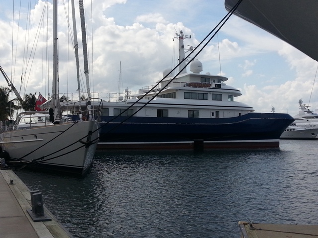

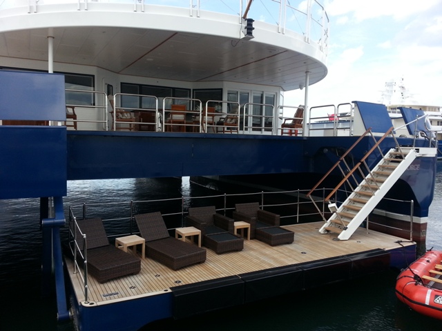

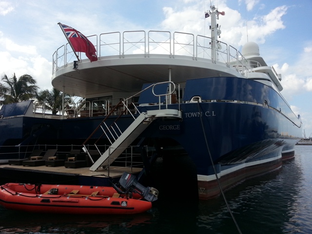

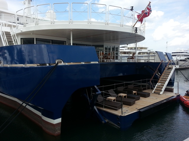

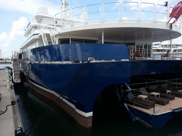

    You don't realize how totally massive Silver Cloud is until you meet her up close and personal.
    Here she is in the Rybovich Marina in West Palm Beach several weeks ago.
    I definately needed a wider angle lens to capture more of her in the same frame!
    I like everthing about Silver Cloud except her draft of 13.5 feet.

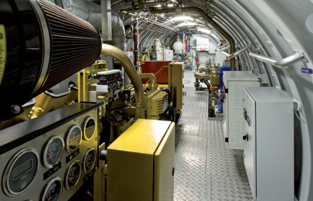

    As far as I know, Silver Clud was the first SWATH (at least from A&R) that has her air breathing engines and gensets in her torpedos. All others have electric motors down below the waterline and the gens at deck level. Those "noisemakers" down in the torpedos (or politically more correct, buoyancy bodies) makes her a very quiet boat. See picture of one of her engine rooms. It remembers one on a submarine. And believe me, it is a long way to the other engine room. The engineer will be in top condition after a long journey.
    A SWAT has in certain limits a variable draft. The optimum draft and pitch attitude is maintained with the help of ballast or trim tanks. For harbouring, you can empty those tanks and reduce draft. But it is still a lot. And doing that, you give up her rock stable behavior.
    The second picture shows SC totally out of trim, most probably for minimum draft.

    Also, now I have seen the machinery spaces I am in love...
