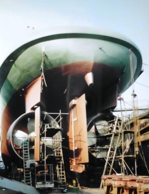

    Here is an example of the propeller and rudder arrangement of Oceanic, one of the 4 large Salvage Tugs. The 4 sisters are (were) Pacific, Oceanic, Artic and Simson. All retired and sold / converted, except Oceanic. She was on "deactivated standby" status at Bremerhaven and for the last time reactivated in 2011, when Nordic was in Dry dock for repair. She was for sale, as far as I know.

    Those are some POWERFUL looking props, ...definitely not for a cruising vessel

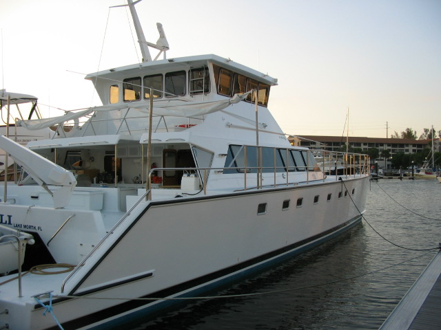

    Here is another powercat owned by a good friend of mine down in Fla. I posted a number of photos over here:
    http://www.yachtforums.com/forums/123583-post41.html
    http://www.yachtforums.com/forums/general-yachting-discussion/15706-new-yachting%3B-13-million-spend-3.html#post123586
    She is perhaps to small for you HTM09, but if your were to consider an 80 footer she could be blown up in size. Nice enclosed upper-wheelhouse as well.
    If you wanted to 'experience' such a powercat, I'll bet I could get you a ride on her. I'll send you a private message (sent you an email).

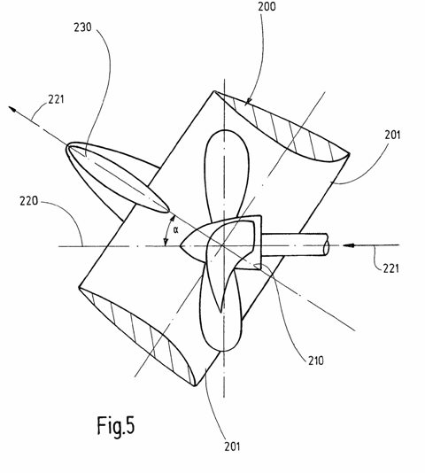

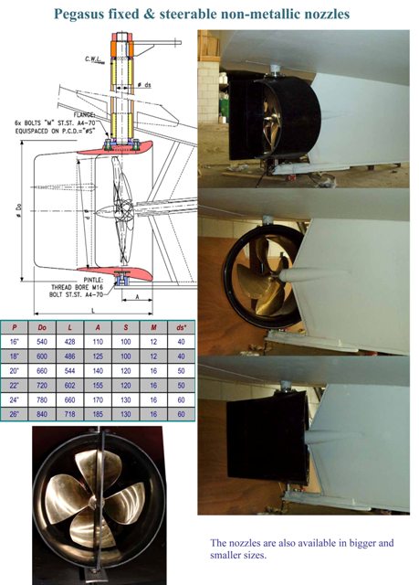

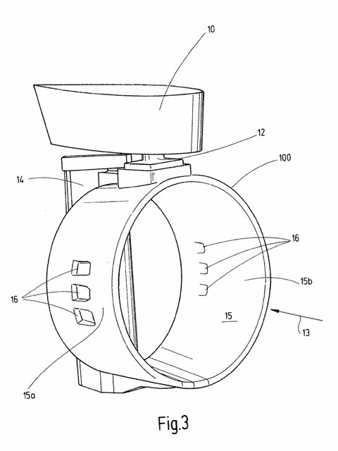

    There is one other version of a propeller nozzle on the market for quite a long time now but not very well known. Called the Pivotable Rudder Nozzle. On this version, the focus is not on bollard pull, also it is thrust augmentating, her it is a combination of rudder and nozzle with less cavitation and good steering authority by vectoring thrust even at lower speeds. This type of nozzle is excellent for smaller displacement boats and yachts (roamer?). They produce a very small wake and very small prop noise. I have seen them being used on river boats, which regulary work on enviromental sensitive inland water ways and lakes. But they are also usefull on work boats and tugs. The openings in the nozzle are just one variation of this nozzle, in order to minimize recirculation. Below are examples of the principle and of the Dutch company Poseidon and their Pegasus nozzle, used for pleasure boats.

    HTMO9... very interesting.
    I happen to know a thing or two from my experience aerospace.
    Those annular airfoil shapes are very low drag compared to a conventional wings or rudders as there is not tip vortex phenomena... where the circulation flow around the wing escapes the tip and creates drag by basically creating little tornados pulled along by the wing off its tips... these annular types of wing about 1/2 the drag typically of a convention blade situation.
    They are also resistant to flow separations at high angles of attack. But they would not be practical on a high speed yacht! Note... if you looked at attached flow patterns on the ring wing surfaces you would see strong circulating currents on the wing surface at high angles of attack... these can be surprisingly predicted and calculated.
    Very interesting not seen this on boats... !
    The prop in there really complicates things particularly being at a critical point.... using the annular shapes for rudders without the props inside would still give much the same effect... very high rudder forces!

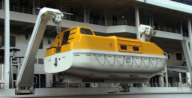

    Oh, I forgot, they are mandatory item on SOLAS life boats or rescue boats if not equipped with outboards or waterjets. Reason: protection of people in the water. Outboards must have a protection ring around the prop.
    picture of a Fassmer SOLAS life boat
