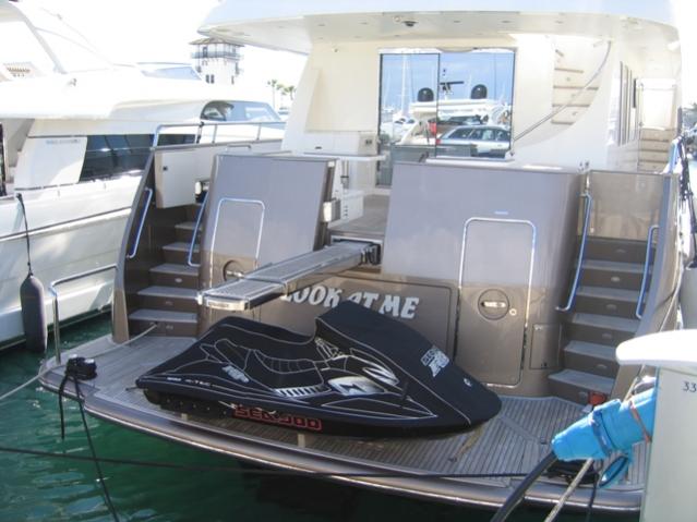

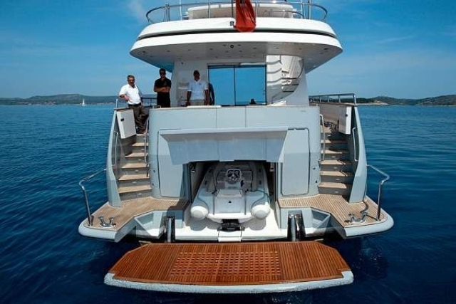

    That was just an answer for that "why does a retired couple need a 200 ft poweryacht?" Capt J, you are absolutely correct. 75 ft can not be a true expedition yacht. It is a minimum effort circumnavigator. Thats why we ended up with app. 200 ft.
    The EP 77 has 3 possibilities for tender storage. If you want the internal tender storage, there will be no adequate crew cabin(s). See below.
    But it is still a nice boat. A true live onboard. And a true semi custom. You just cant have it all.

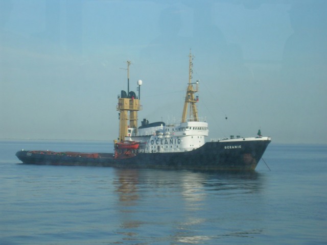

    Lone Ranger (ex Simson)
    The yacht Lone Ranger has in fact only 8805 HP and a bollard bull of "only" 135 metric tons.:rolleyes:
    Simson was the second tug of a series of four identical ocean going salvage tugs of the Hamburg Salvage and Towing Company. The tugs had more than 13000 HP and were modified with Cord nozzles and the bullard pull was raised to 179 metric tons. How Simsons propulsion was modified later in its yacht conversion, I can not find out at the moment. But 8805 HP is still rediculous for a yacht of this size, I must say.
    The picture shows one of her sisters on her standby position in the German bay.

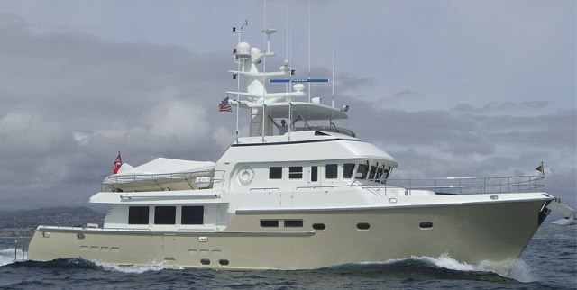

    Nordhavn 76 FPH
    That is the Nordhavn 76 forward pilot house. The one I like the most. Are they still building this version? All other info is only showing the aft PH. You are right, that is a true expedition yacht, but with much more workhorse than yacht appeal. Great boat.
    The other company I do not know.
    Copyright Nordhavn

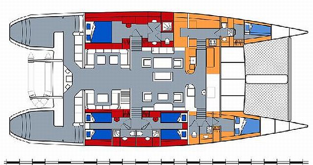

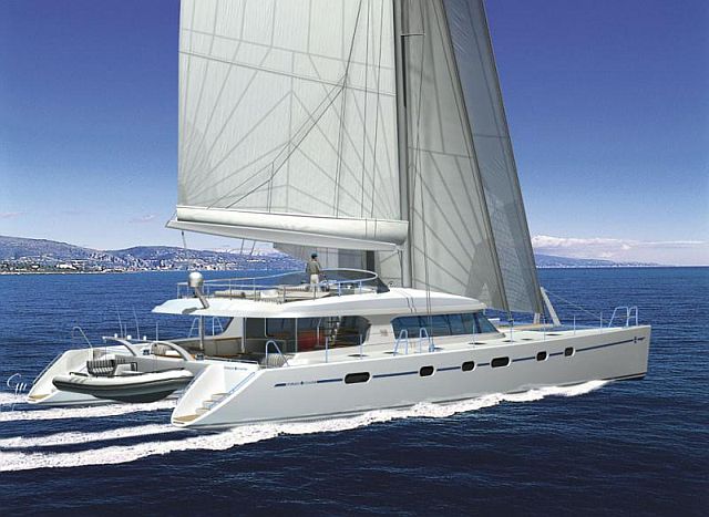

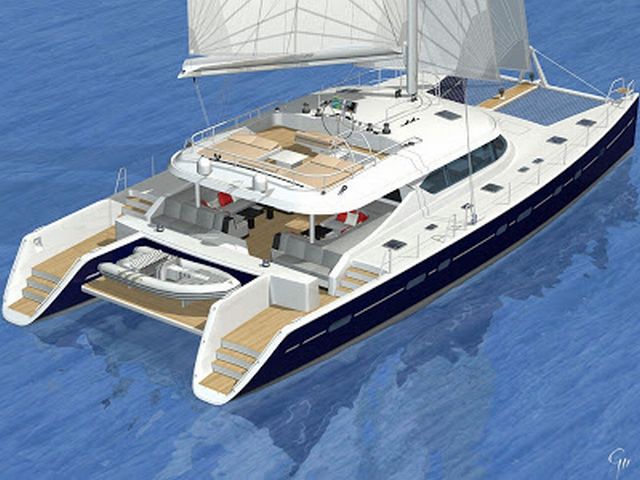

    Exclusive 76 by Multiplast
    This one might be a little small for your consideration, but I might consider one of these vessels WITHOUT the sailing rig....nice looking vessel. And if done properly the aftersale market for the vessel could include the addition of a sailing rig by the subsequent owner.
    These fellows at Multiplast have been biulding really top quality multihulls that have raced around the world numbers of times.
    Cruising multihulls - Multiplast
    You appear to have this 'preference' for metal boats. I would suggest that a really good quality glass-sandwich construction can offer an awfull lot of pluses to metal, particularly in multihulls....just two, lots quieter, much less condensation,
    Have some more pics if you want to see them.

    As KIWI pointed out, Artic P (ex Artic) is a former sister of Lone Ranger (ex Simson). Artic and Oceanic were the last 2 large salvage tugs (total 4) of the older series left in this German Shipping company. A new type of even more powerfull tugs developed and build for that company, is the Nordic class. Attached you will find the particularies of ETV Nordic, just in case some of our members wants to convert her in to a yacht in some 21 years time.:cool:
    This Tug is on charter by the German government for 21 years as an emergency standby tug in the German Bay. Because the German Bay is one of the highest frequented shipping areas in world, there is always a large salvage tug on standby in that area (24 h a day / 365 days a year). If one tug goes on duty, a second tug takes its place.
    So after this charter you can buy it and convert it into a nice yacht.:D
