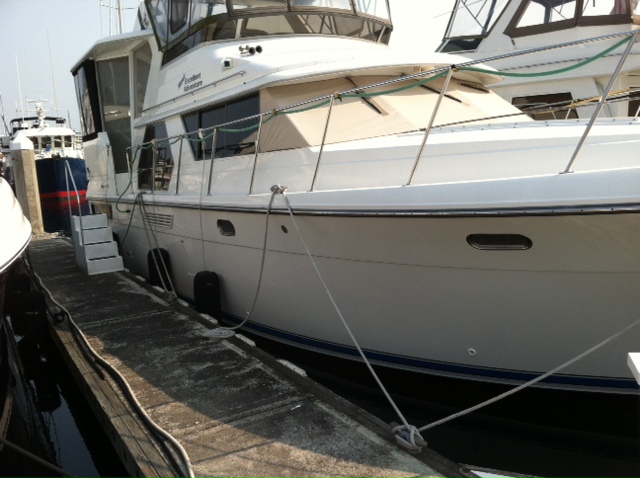

  11. hopper5
    hopper5 Member
    Oct 23, 2012
    102
    Olympia,wa
    picture of shine ??
    This is what the gel coat is like now....I have not waxed it since I bought it last Fall.....Can I get away with a light polish instead of a compound and then use the nano / sealer ?? FYI, I have replaced the flybridge canvas and glass. Thanks

  13. Capt J
    14,889
    It is really really hard to tell with a picture. But judging by the relfection in the picture, it doesn't appear you have a lot of oxidation. I would do a 1 step compounding with aquabuff 2000, which is slightly more abrasive or slightly more heavy duty than finesse.......If you buff it correctly, you shouldn't need to use swirl mark remover, although that doesn't hurt.
