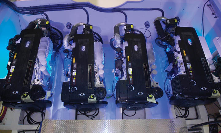

    B04C92AC-A609-42DB-9E5C-E32631EABEE7.jpeg Hi I have a quad Volvo 600 IPS with original 2008 Simrad AP 26 Autopilot. Pilot is connected via gateway to Volvo IPS drives. Holds steady on “Auto” but I would like to connect to my new Garmin 8616 plotters and use the “Nav” function. How would/could I accomplish this. Any help would be appreciated.
