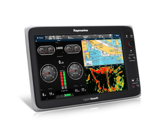

    You need the Raymarine ECI-100 Interface (not expensive at all) to connect the engine data (provided the sensors on your engines are compatible) with your Raymarine network and display all data on the Raymarine cockpit displays and download all data via USB to your computer. It even works via WIFI to your tablet. Great system.
    My son has this system on his quad IPS boat, works flawless.

    The Raymarine ICE-100 engine data interface comes for less than 300,- $ and it is made to interface Volvo Penta engines with Raymarine systems. It can be freely configured and displays all data provided by the engine sensors on Raymarine dispays. And it is more or less plug and play. Allmost anybody with a little bit more electrical knowledge than me, can install that system themself.

    I do not want to start a competition between those systems. Both may be as good as the other one. But as far as I remember, the information can be freely configured. The ICE-100 just interfaces the engine data into the Raymarine network. The only fuel related info, I think, was fuel flow, fuel temp and may be fuel pressure (in the supply line, not in the common rail system of course). All other fuel calculations are done by the Raymarine computer and have to be configured. It is just a signal converter for Volvo Penta (analog ?) genuine data into the Raymarine network data protocol.
