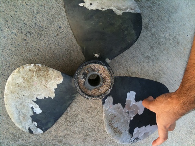

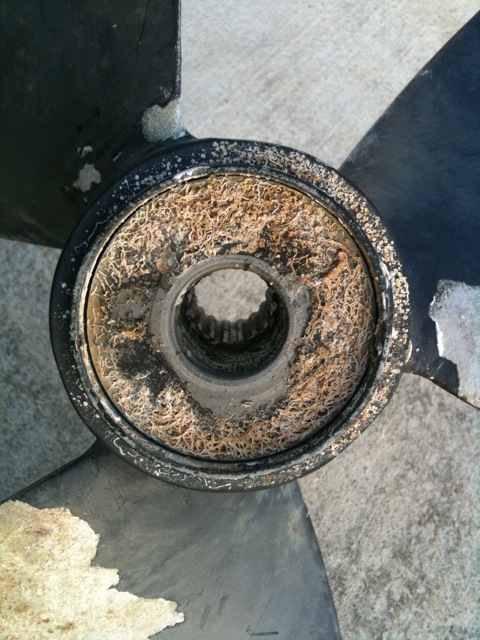

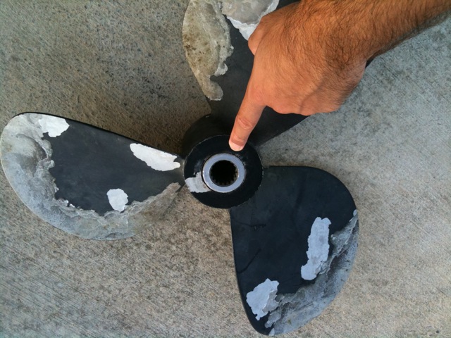

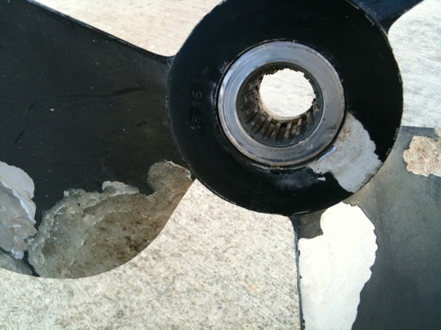

    Just an update FYI; we had to replace the propeller on our boat (D2-75). I have attached the pictures of the old one after the diver replaced it with a new prop.
    Basically, the Volvo dealer stated that the flexible part covering the propeller on the inside (I don't know the exact term) was a faulty production. They covered the replacement under warranty. The Bavaria dealer also stated that D2-55's also have this propeller and/or gearbox problem. The vibration around 1300-1900 RPM is a good indication that the prop will fail in the future.
    The way it happened was that after warm-up and cruise operation at 2000 rpm half an hour into our trip, we lost forward drive. I thought we wrapped something up and dived under the hull, there was nothing. So the prop almost 'came off' :). The dealer ordered a new prop from Belgium and the marina diver replaced it. We tested the operation without the prop, the transmission runs smoothly, so its fine, no faults there.
    Also, look at the way the paint has come out below, this is 9-10 months old.
    Anyway, D2-75s and D2-55's have gearbox problems, confirmed by the dealer and Bavaria in TR. Its mostly because the S-Drives are manufactured I presume.
    If anyone else has comments to make, I welcome your opinions. Regards, VR.

    The DPH drive has NIBRIL props that have terrible corrosion problems (they are allergic to saltwater).
    The regular saildrive comes with an aluminum prop. I've never seen one as badly corroded as this one on a saildrive before. Are the zincs working?
  8. vivariva
    vivariva Senior Member
    Dec 10, 2007
    187
    Istanbul, Turkey
    -Thanks for the link K1W1, I will read the contents, much appreciated.
    -We just checked the zincs, they are working and there is no corrosion on them at all. We thought there was an electrical discharge in the marina water however that is not the case.
    The dealer sells epoxy primer and black paint for the propeller, we'll use them if this happens again. We're going to lift the boat out around April.

    For future reference, I wanted to conclude this thread by relaying some information, which we heard directly from the dealer (Both Bavaria and Volvo) in Turkey.
    These Volvo engines are experiencing a high frequency of transmission and prop. failures on many sailboats. Some users have lost their propellers (literally came off in some instances because of the bad quality materials covering the centre.) and were unable to motor back from a Greek island to Turkey.
    The manufacturer is aware, and the existing boats might need replacement parts, and these need to be sent from Belgium or somewhere else. It takes almost 10-15 days for delivery. There are a few other parts requiring changes if this happens, I will post the details if anyone needs more info.
    Basically, if you have a sailboat that uses a D2-55 or D2-75, be careful. Also, the transmission might not engage the gear during docking, if going in& out of gear multiple times. This is also a manufacturing defect, found even in Bavaria 55's engine (new Farr-designed cruiser), the flagship model.
