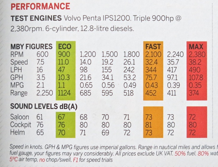

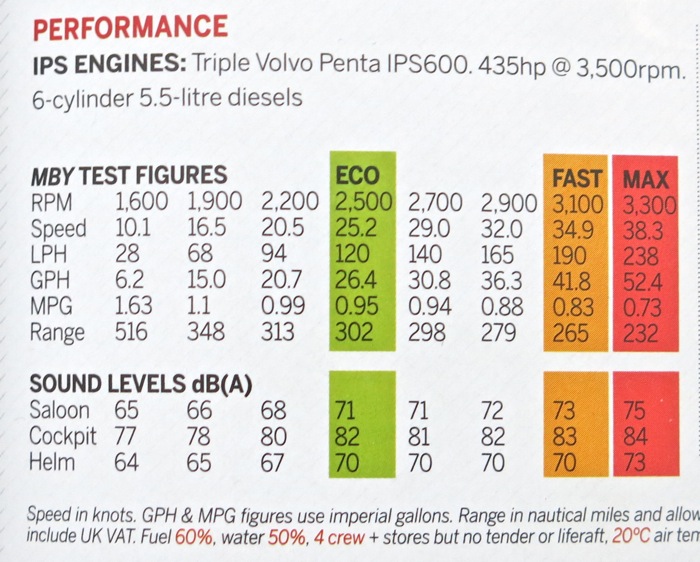

  12. AMG
    5,392
    I just have the figures from MBY when testing the Delta 54 and 80. Today most Delta 54 are with twin D8/800 but the figures are almost the same as with triple D6/600...

  14. Capt J
    14,887
    The older Cabo 40' express (or FB)
    800 mans with shafts @ 80% load 32 knots cruise, 63 GPH
    600 cummins ZUES @ 80% load 33 knots cruise, 45 GPH
    I've run dozens of each and the speed and fuel economy was the same. I was the Captain that ran the MAN boat for the seatrials and the zues boats. Boat is exactly the same, waterline up, except bottom modified only where the pods mount to accept the pods and Zues boat held 80 gallons less fuel.
    "Based on my sea trial and discussions with Cabo’s factory captain, the 40 HTX’s best cruising speed, with respect to economy and engine load, is 2,710 rpm, making 32 knots and burning 45.4 gph for a net of 0.71 nm per gallon."
    Cabo 40 HTX | Boating Magazine
    Scroll down to page 7, man R6-800's Cabo 40' express 2100 rpms 31.5 knots, 63 GPH.
    Std Sea Trial_C32X-08_CAT C7.xls (channelblade.com)

    More specifically, for AMG:
    Thanks for your attention, but I hope you will accept that your Delta numbers say nothing in terms of efficiency comparison with shafts, because they only show that Deltas are very efficient boats overall.
    As you know much better than myself, not only they are designed from the ground up around IPS propulsion, with flat stern sections, but they are also built with technologies that make them very expensive but also very light, hence efficient.
