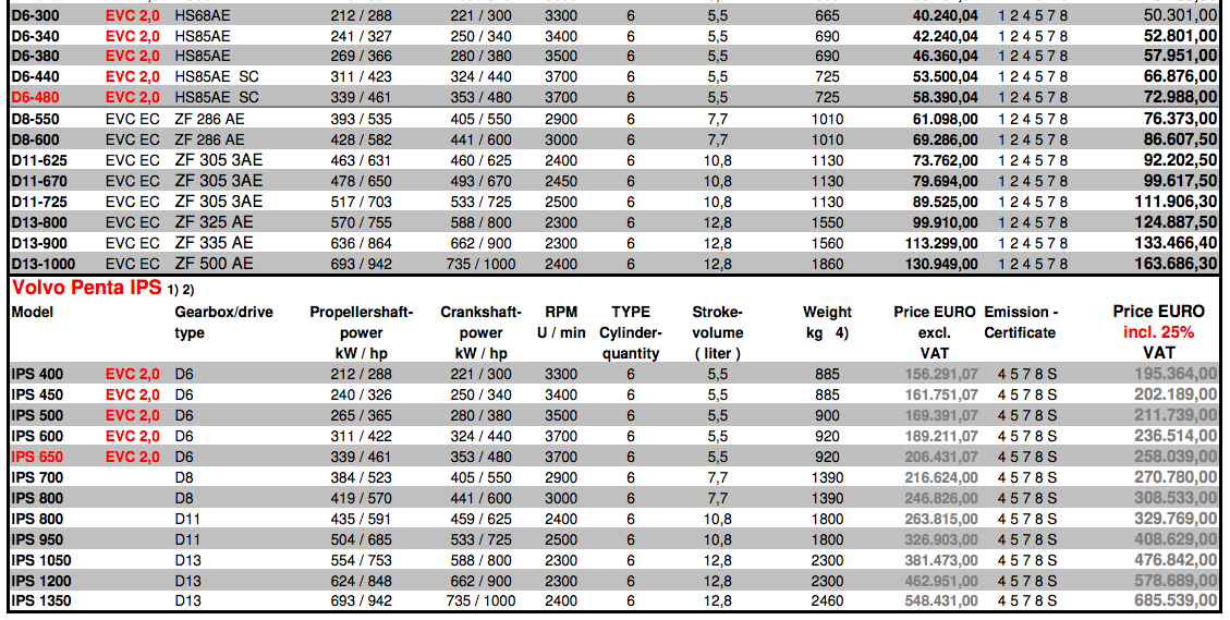

  17. AMG
    5,392
    To start with, the same engine with IPS are almost twice the price vs gearbox from Volvo Penta, then you always need a minimum two of them. I don´t think that two shafts and rudders are that expensive.
    No, Delta are not with shafts, but I have three shaft boats myself so I know what they are...

  20. AMG
    5,392
    I just picked the prices from the net, and you must consider that IPS are twins for this price. But still almost double and not LESS as you wrote above...
