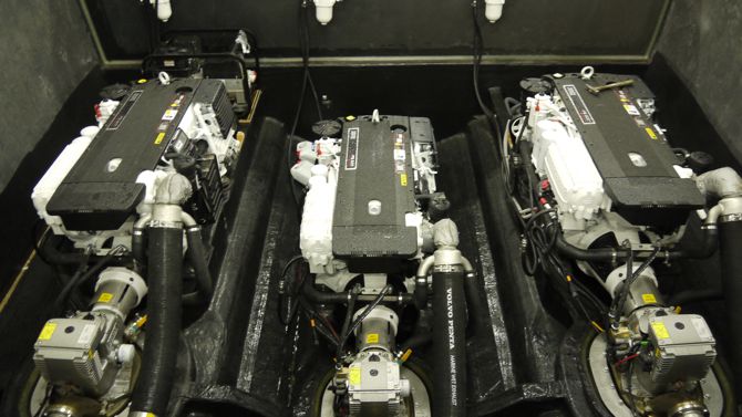

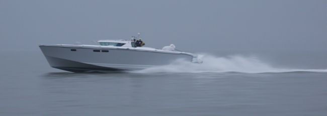

    We have now installed triple IPS/600 in our first D54 hull and it performed very well, almost 42 knots and with less wake than most boats this size.
    If you think the superstructure looks small, it is because we simply put a D29 inside the hull for the initial testing... :)

    Hull looks very nice, beautiful bow profile.
    Why do you choose triple IPS 600 instead of twin IPS 800 with more power and less weight?
  10. AMG
    5,392
    Thanks Orion, we had the idea to use twin IPS-2/900 but they are larger, more heavy and more expensive I think. If they are more powerful, I don´t know, maybe we will test them as well in the future, but this triple installation is the most efficient for us at this point.

    And Lars, great looking hull! What is her projected wet weight?
  12. AMG
    5,392
    Thank you for the confirmation on my conclusion. Our hull is now built with carbon fibre and vinylester infusion and the whole boat will be built as light as possible. During the trials we had a total weight of 12,5 tonnes which is about what she will be when finished.

    It is unique to see the outboard drives on the same plane, or at least parallel to the center drive. This should help to neutralize a bit of the well-known inside turn heel induced by drives in concert with the deadrise. Must have been a challenge to get cleanly down to center with 3 flat drive faces. I would be interested to hear the load comparsion of the center to the outboards in that configuration. No doubt she is fast!:eek: What a great project, I envy the fun you must be having.
