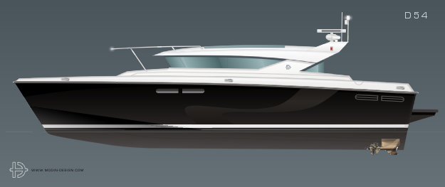

    I am in the middle of this now, started to develop a 54´hull for the IPS II (pictured), but found out that the added size and weight of the IPS/900 will be negative for the outcome and I am now back to using the IPS/600 as double or triple installations.
    This hull will be purpose built for the smaller IPS and since none of the IPS drives have props for more than 45 knots, this will be the top speed anyway.
    I agree that more power to stern-drives would be better, but the joy of joystick handling is not there yet and I don´t think they will work as smooth as with IPS.

    :) I can envisage a purpose designed hull with triple IPS set up being rather amazing Lars. Puts a different slant on things power to weight wise.

    Yes, it will be a 25% weight saving and the flexibility of using two or three. Plus the hull can be with more bouyancy with smaller drives. We are building very light and today many of our competitors are using 50 % more fuel, going 10 knots slower. Hoping to achieve similar results with this one..:)

    I'm not asking the question, but I'd be very interested in seeing your take on the centreline engine / keel treatment one day. :) There's a few reasons why I shouldn't, but the interest is there.

    Absolutely, as soon as it is launched! :)
    The fact is, I have several ideas but nothing is in my computer yet. I think this must be tank tested, even if I have no idea what I will look for...:D
    My main concern is not to achieve the speed, but building a light boat that also has a smooth ride in rather heavy sea. It must also be as silent as possible, which always is a problem with a light and covered boat where the noise from hitting the water at high speed can be pretty annoying...

    AMG, your point over triple 600 vs twin of the new IPS 2 is interesting. But I am so curious about the need for a "tank test". It is my understanding that Volvo Penta has been very open in support for designers/builders through the BEIC (Boat Engine Integration Center) and with the relationship with Donald Blount that many questions have already been answered regarding triple and quad installations. Certainly information on the new higher horsepower like in the Lazzara 92 is harder to come by so far.

    The need for tank testing is more to find out the hull resistance with different loads as I intend to make something very different and special for this power option. As you say, it will be only IPS since all is built around them.
    Personally I like sterndrives better, for many reasons, but except for a small power increase I don´t expect them to compete with the POD drives when it comes to boats above 50 feet.

    AMG, certainly a valid point. The arrangement can make significant changes in the LCG and other important matters. It deserves the proper investigation.
