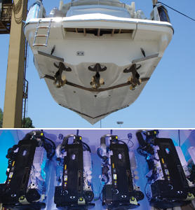

    Just a quick aside but if you look at the photo of the triple IPS installation shown above, those transom anodes from Volvo are Aluminum and not Zinc.
    They crumble like hell, Volvo have modified them but why not just make them in Zinc? :confused:

    More pictures of triple installation.

    How come there are 3 drives shown but 4 engines?

    I'm sorry for not pointing it out but it's two different boats, the picture showing four engines is from the engine bay of the Lazzara LSX 75 Quad IPS. No idea what the other boat is, maybe someone else does?

    The triple is the Absolute from Italy.
